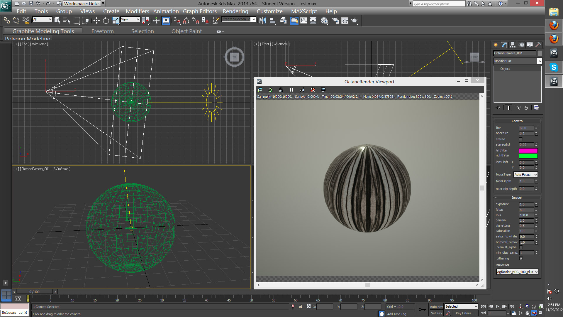

Karba wrote:
jcuratolo wrote: There is no environment map right now, just octane sun, octane camera, and sphere with liveDB mat. Everything else is as it was installed.
Your sphere looks overexposed. Try to reduce exposure.
Thank you for your attention to this. I changed the fstop to 8. The colors are still washed out no matter what gamma or exposure settings I use. Incidentally, standalone renders just fine (comparing the same mat). Any ideas?

Karba
Posts: 2300
You can try to set response to linear

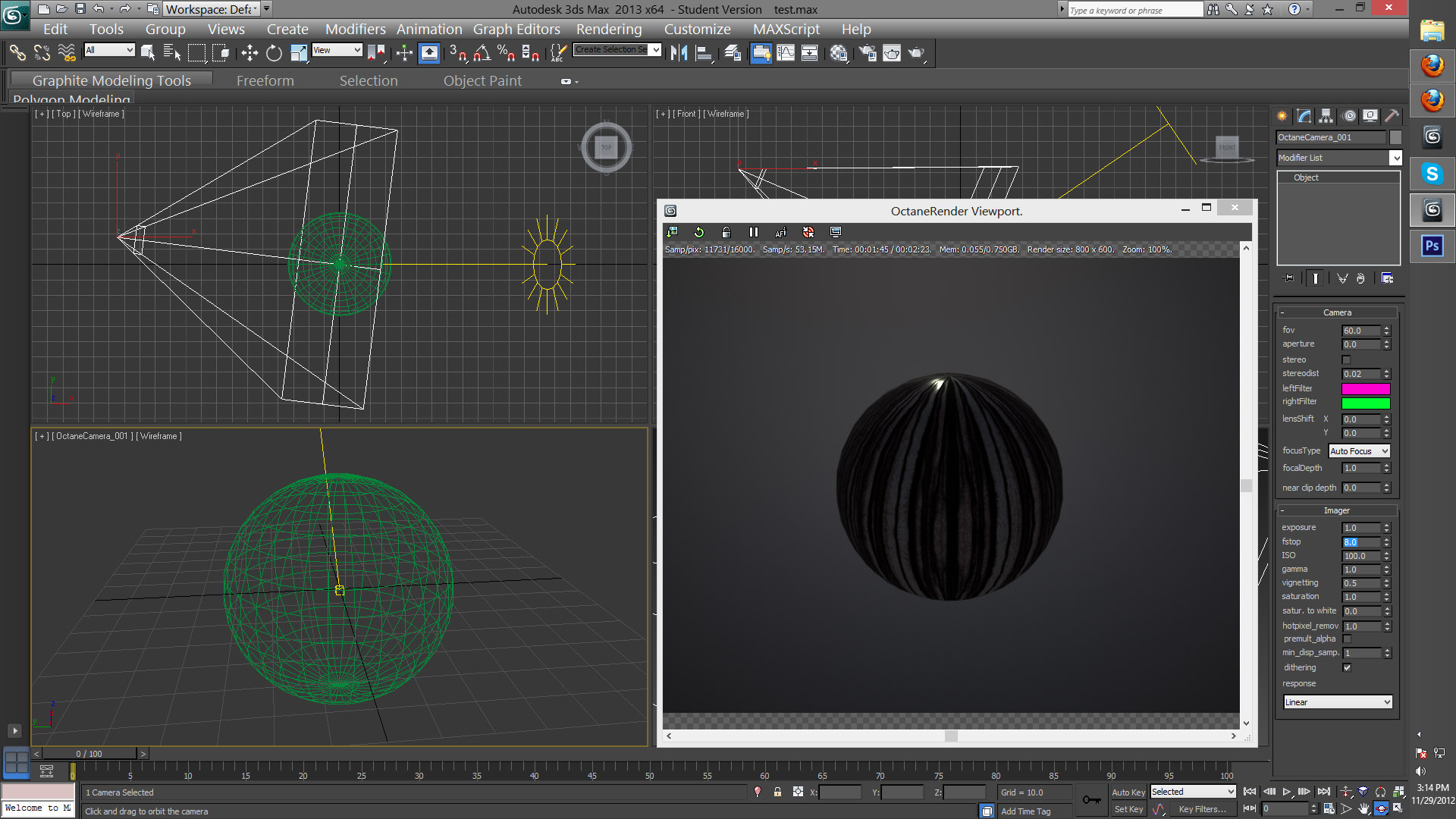

Karba wrote:
Here it is set to linear

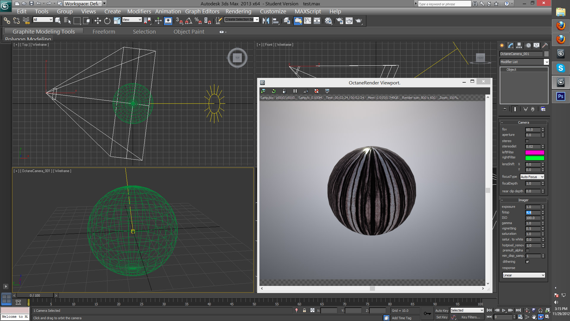

And then fstop adjustment with all else the same
