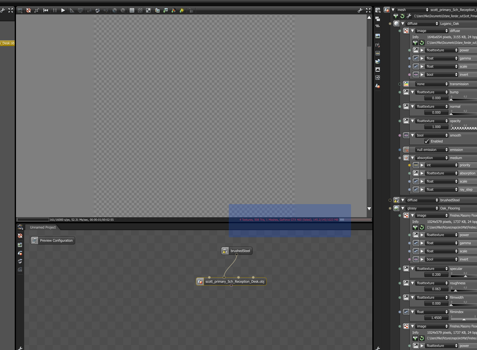

I think i've found a problem......It's a stability issue
to recreate it,do this:
1) Load or create a scene
2) add a placement node in the graph space
3) click on your scene, then back to the placement node.
4) select and delete it with the delete key on your keyboard
You can now no longer select your scene and you get a error ...see attached image

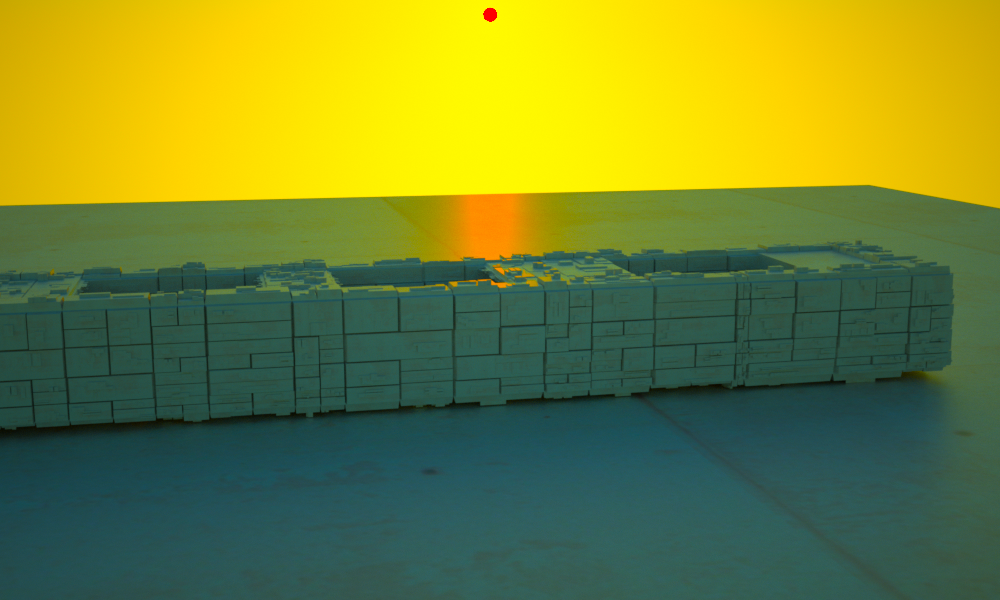

How is the colour of the sun determined?
In the image below I was messin' with the sliders and I notice the sun colour fades in quite quickly in some cases.
At 2.75 saturation its only just one or two pixels showing as red and then by 2.85 its an all red disk. Seems quite abrupt and the few pixels here and there doesnt seem visually correct... The turbidity slider seems to have a much more gradual effect although the some red pixels issue is there as well. I would have thought the colour would change through red/orange yellow across the whole disk :idea:
Hour of the day - its about 530 am in the pic - seems to have a rather abrupt transition in sun colour too 5.35 its red then at 5.40 its yellow.
Doesnt always seem to be a good match for the background sky colour either. A red sun in a yellow sky? dunno...

roeland
Posts: 1826
The daylight system currently only works during the day. We don't have a night sky model at the moment. The color of the sun is only correct if it is above the horizon.
What are your exact settings in the daylight system? And did you increase the saturation in the tone mapping? The sun appearing this red could be an artifact of highlight clipping.

Cant reproduce exactly what I had in the pic before but here is an .ocs of a similar view that goes with the 3.02x_test_scenes OctaneBenchmark file. Click on the RenderTarget PT. Play with time of day 5.3-5.4 and the camera saturation 1.4-1.7 to make it appear/disappear/change colour. I guess it is related to the sun being near/on the horizon.
Dont get me wrong I think the capability to have colourful sunsets/sunrises would be cool from an artistic viewpoint. ;) its just the background colour doesnt go...
edit: fiddle with the turbidity too to make it partially visible about 2.4-2.7
HTH :geek:

roeland
Posts: 1826
Yeah the colors in sunsets aren't ideal yet. The red sun is indeed because of the tonemapping, which by default uses per-channel clipping. Turn up the saturate_to_white slider a bit to avoid this.
