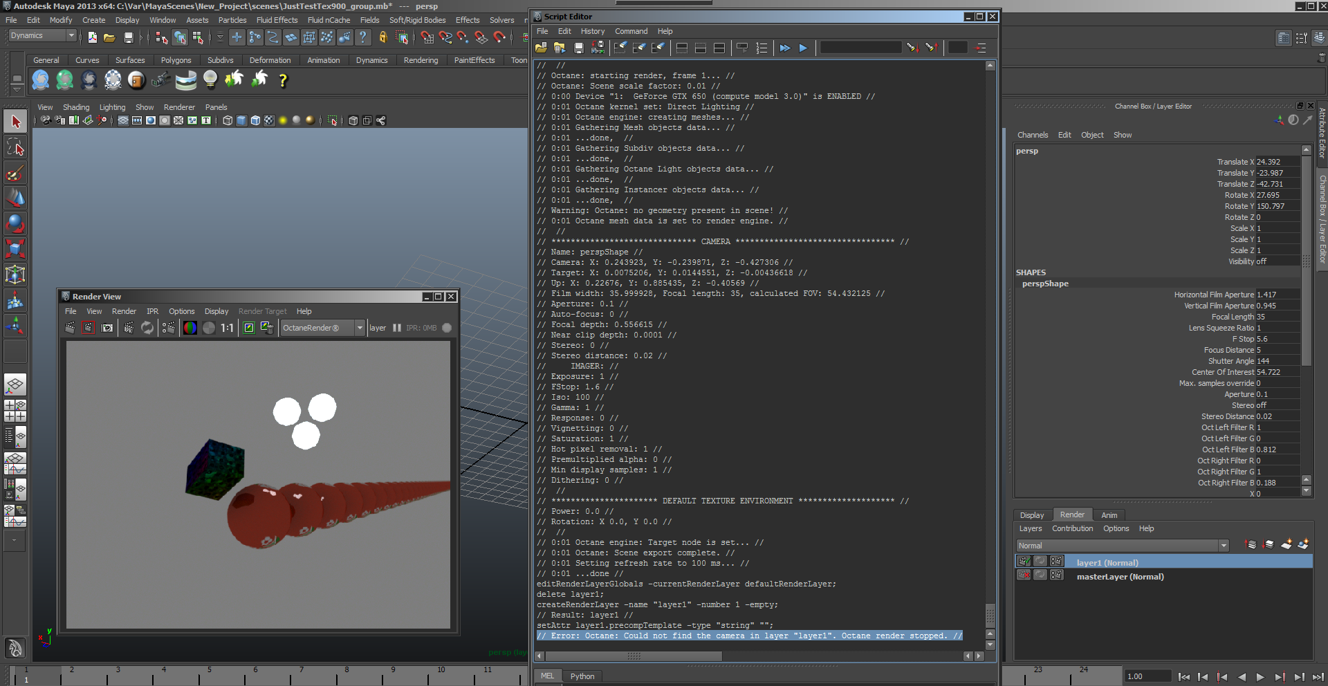

-Octane doesn't render any render layers except for masterLayer and I receive an error message:
// Error: Octane: Could not find the camera in layer "Octane". Octane render stopped. //

arh-osa wrote:-Octane doesn't render any render layers except for masterLayer and I receive an error message:
This message appears when the camera you are trying to render from is not included in the layer which you are trying to render...
I tried to associate cameras in Relationship Editor and get the same result. V-Ray for instance works with the same scene correctly for all render layers without error messages.

arh-osa wrote:I tried to associate cameras in Relationship Editor and get the same result. V-Ray for instance works with the same scene correctly for all render layers without error messages.
Strange, it works in my case OK:
I create the empty layer "layer1", if I'll try to render it, I'll get the same error:

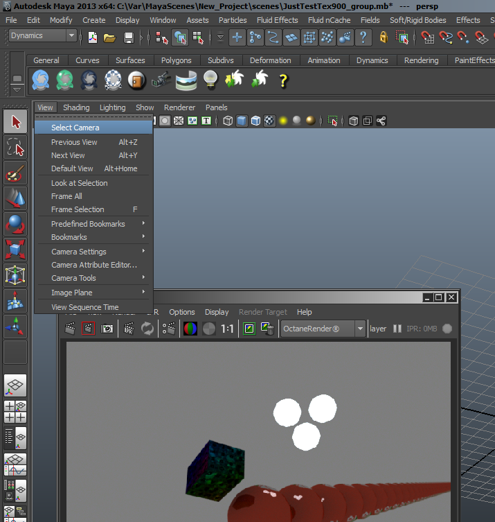

Select the objects and camera:
Add them to that layer:

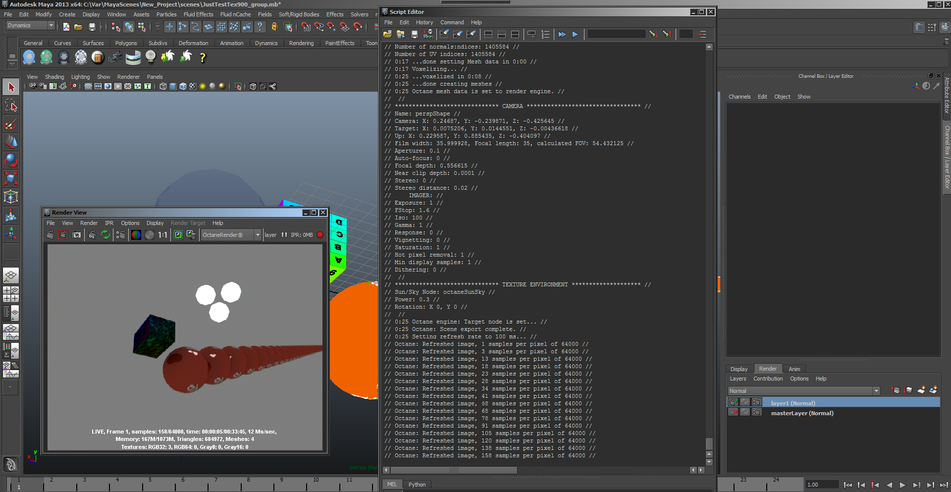

Press IPR, and voila, "layer1" is rendered:
