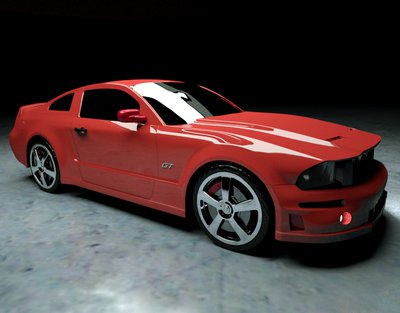

I can totally see where Octane Render is worth the investment. It is a great product and the future of rendering. Once I get a better video card, I'm sure I will be able to unleash the power of Octane. I messed around with direct lighting a little bit more, and was able to get some great results in the 8-15 minute range on my gts450.
I figured out how to import an environment hdr, although I haven't been successful to get a clear plane that can cast shadows.

Agreed, play with the roughness on the tires - increasing it will give a better rubber look. (unless you are going for the polished tyre look!)The latest render is a vast improvement.

You cannot expect wonders from Octane.
Like any other Render engine it needs experience to get good, realistic results.
No matter what hardware you use!!!!
My first rendering with Octane was that
http://render.otoy.com/forum/viewtopic. ... cia#p59772
- Done on my laptop with a GT 425M that has 96 Cuda cores (instead of 192 like the GTS 450)
- Resolution 2560 x 1600
- Rendered in 1h 50min.
- The settings were more or less default (i had no idea about the settings)
- + Experience!
Your last picture looked WAY better than the first one!
So keep on trying, and the more you experiment the better you get...
