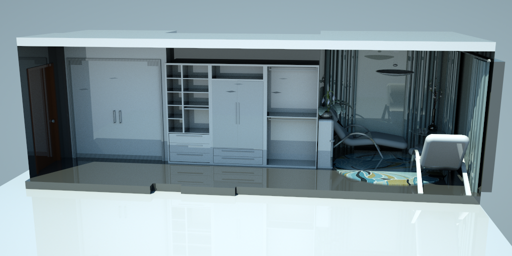

I got animation working using 8 pixel quality, though it didn't exactly do what I expected - It rendered one frame for each SKP scene without tweening or transitioning between them like it does in Sketchup (7 Free). Regarding opacities, I was starting to suspect a limitation, intentional or not, in the current Octane beta but I can see where it is practical. I finally figured out how to identify material names in Sketchup so resetting the opacities after the initial import shouldn't be a problem because I'll know which material names to look for. I'm doing most of my tests with free interior scenes from Google's 3D Warehouse and the one in particular I tried last had close to 50 materials and they're not all intuitively named which is a pain. I'm sending you the files via pm so you can see the opacity differences I was seeing.
*edit*
My files are too large to send via the forum so I'll just link the original model and upload a render of what I get in Octane. The original is a model from Google Earth which I downloaded for free to test out how Octane and Sketchup worked with each other: http://sketchup.google.com/3dwarehouse/ ... revstart=0
No material modifications.

If you have the 'Export Camera' option checked your animation should take the camera from each frame's scene.
If you don't have it checked, it'll use the camera already set in the .._anim.ocs project.
Then if you don't have 'Export Sun Direction checked either all frames will render to look the same - you told it to change nothing except make nnn steps of frames that look the same !? :roll:
It lets you NOT change the camera [and so use the ocs fixed one] BUT then change the lighting as taken from each of the SKP scenes - e.g a sun-path/shadow study.
OR
You can change the camera in each frame, BUT keep the lighting constant [i.e. it's unchecked] -so it uses the lighting as set in the ocs for each varying view.
OR
You select to change the camera AND the lighting - to match those in each scene per frame...
So, make sure you have at least one option checked... UNLESS you want every frame to look identical ?
Unfortunately you do need to have some grip on your materials as you need to adjust them in Octane as well as place/change them in SUp...
Take a moment early on in a SKP project to print off a scene in draft from SUp and annotate it with its materials, as read from the SKP - a quick way to do this is to use the Materials Browser > Model-tab [and Purge Unused - straight off the list is optimized]. Now select a material and right-click > 'Select' - now all faces with that material will highlight - then you know what it is used for - if it's called "material123xyzdingbat" and it's a wall finish change it's name to "wall1" ! Then it'll be easier to find, understand and manage in both SUp AND Octane... It's you model - take control of it ! :geek:
A well structured model is easier to manage and if you are using Octane, much easier to modify materials within its .ocs project... :idea:
As I said already - Octane simply ignores any material's opacity in the exported MTL file [although it's in the MTL file under 'd'] BUT it is deliberate as it allows you to tweak any materials opacity in the Octane ocs project without worrying about it being overridden when you next re-render your model after changing the SKP...
I'll try and look at that linked 3Dw model - but remember that even it were made in the 3D warehouse it's now yours, and YOU have to control it - remember who's the boss :?:
