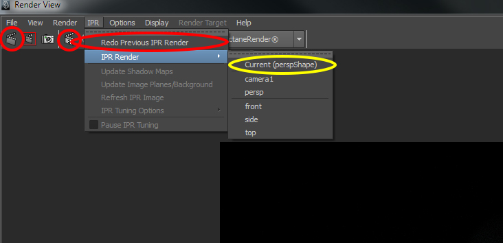

Found a bug in this new version where the current camera in the render view will always be the default persp camera no matter which camera was last rendered or is in the active viewport. This used to work as expected in prievious versions.
So hitting any of the items circled in red now always renders the perspShape as the current cam (circled in yellow) no longer updates even if the last still active IPR was with a different camera.
T.

Just checked and if you click the render button on Maya's main tool bar without the renderview open it will open and render the active viewport but will then revert to the behavior mentioned in my last post.
