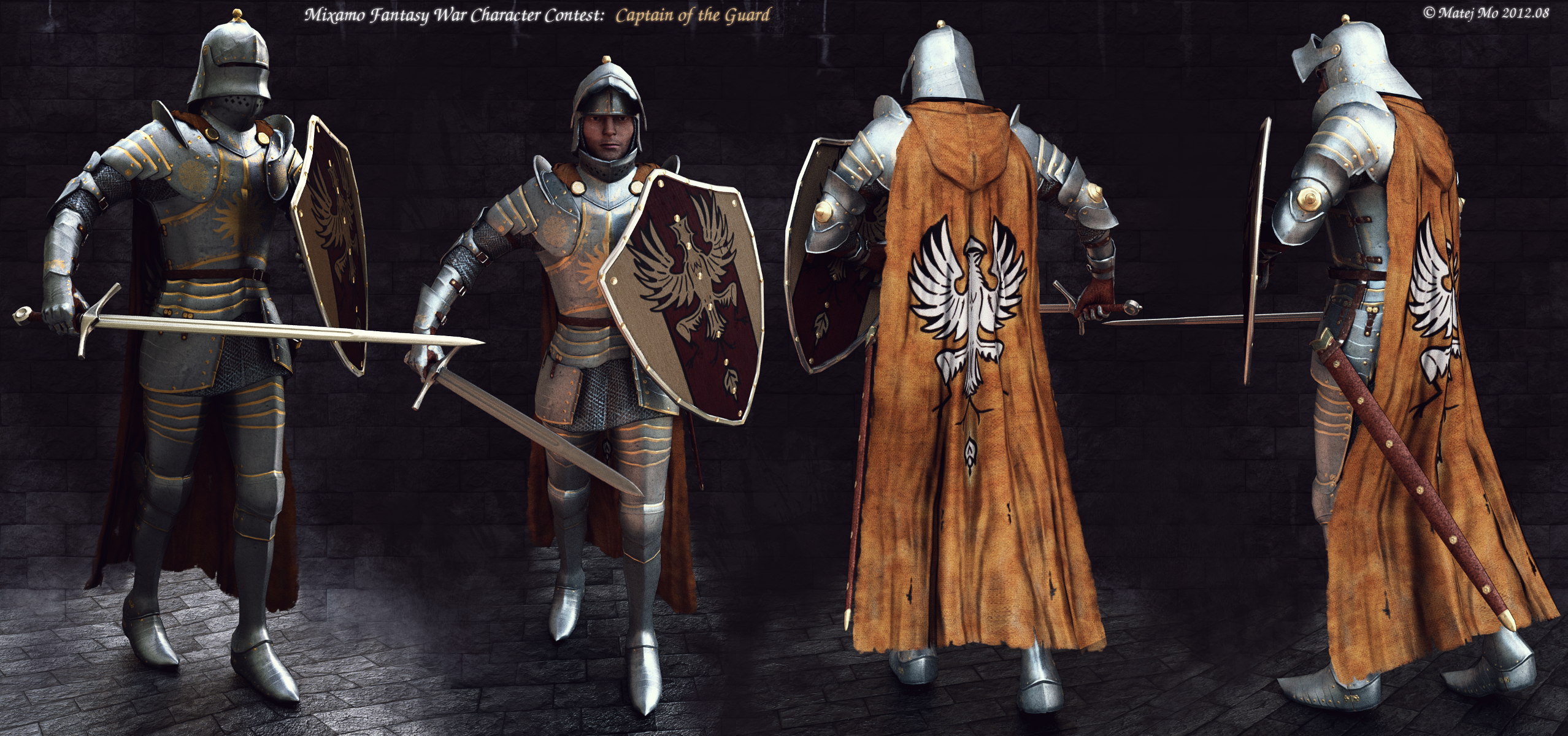

In the end it didn't come out that bad. With a normal map applied and a dark background, the black shading lines are attenuated enough to not show up that much. This is the lowpoly char, fully textured and rendered in Octane (of course

Wow! Awesome work ! Great charecters.
