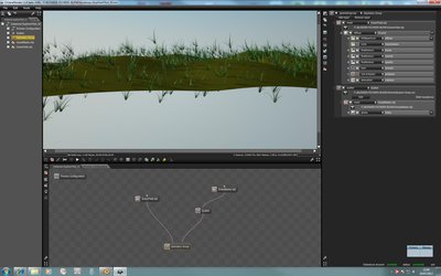

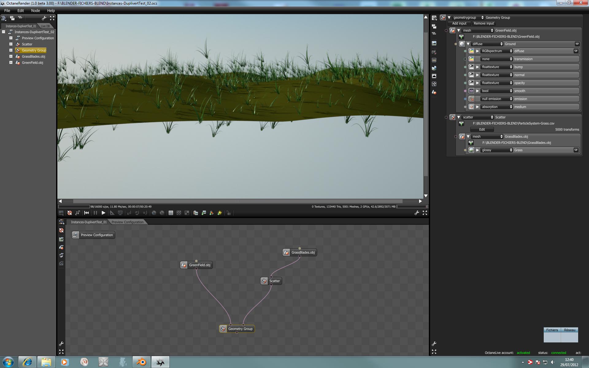

First test with Hair Particles : Grass tufts in a field.
The grass tuft mesh is at World origine (0,0,0). The ground mesh is at World origin as well. Rotation and scale 1/1 applied to both.
1-Exported the Grass tuft (particle object) as OBJ file.
2-Exported the Ground mesh as OBJ file.
3-Selected the Ground (particle emitter) mesh and exported the CVS file.
Rotation enabled on duplicated objects following your advice (tested also disabled).
Problem : The grass tufts are not stuck on the ground , but seem instead to be at random altitude :

@Matej : I have just tested with Planar emitter : I encounter the same trouble ! Very weird !
Edit : I have done an other test, and this time i exported the reference grass tuft with the ground mesh : it worked fine.
I tested again on a bumpy terrain, with success. I then tried again to export the terrain mesh only, and it worked fine.
So it may be a temporary bug. I will do more trials.

@Matej : Edited my previous post as well : it works now ! I have no idea of what was going wrong !
One remark, though : the size of the particles (grass tufts) is not the same in Blender and in Octane. With Dupliface, the size is the same.
