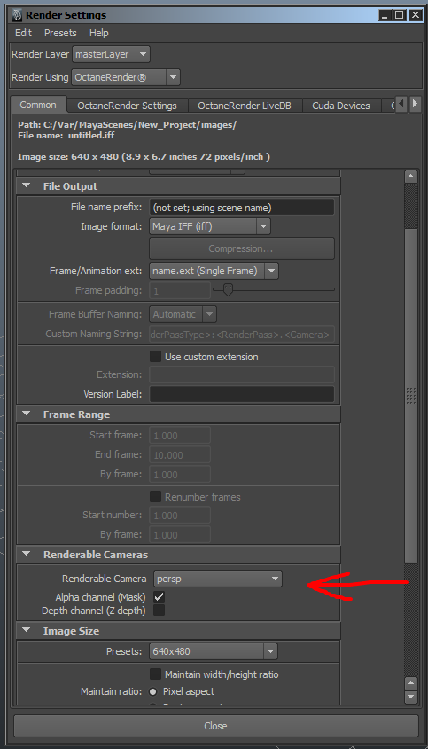

Joss wrote:4. I'm getting an error in few scenes: "// Error: Could not find the camera in current layer "defaultRenderLayer". Octane render stopped. // "
There's nothing special with scene - just a typical camera1 and a couple of poly objects. No any render layers or such.
The only special thing with camera is that there's a custom attribute - distance from camera to spaceLocator connected to camera centerOfInterest attr, but it seems not the case for the error because deleting camera and adding a new one producing the same error.
I can send you that scene if needed.
The camera is not added to the "Render settings" as "renderable".
Joss
Posts: 81
Joined: Mon Nov 22, 2010 12:15 pm
I believe i set everything correctly, even in render globals, although it shouldn't affect interactive experience, since RG basically being used only in batch renders. Also still, even in there's no camera in RG, current camera should be used, since i may setup scene for batch render from one camera, but tuning it from other 5 cameras.
