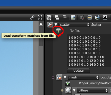

The idea is to upload a csv file or to paste a 12xN matrix, not to do it manually - please see a screenshot.

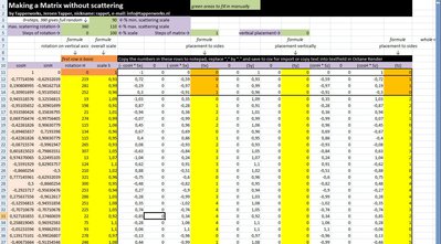

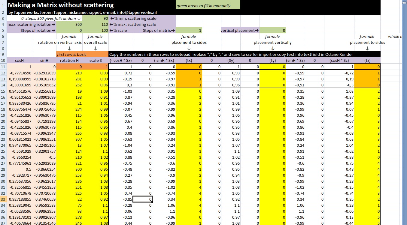

I am working on a excell to make rows and matrixes for making a csv file: works for me in Octane and does not depends on 3d-modeller.
Let me know if you think it may help and I will upload when I have finished it.
The attachments show you a tryout of a clean and scattered matrix of objects and a prntscrn (random showing clean matrix) of the excell used.
greetz

TIG wrote:Is there a way to make Octane import csv information - or must you do that manually ?
You can upload a csv or paste the values from a file - see the screenshot.
Adding a scatter node is manual work but that's it - just one node.
