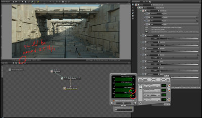

just to put a picture on the problem:
that is a serious issue. Any insight on this Radiance?
(granted that after a reboot , the performance is back to full blast?)
