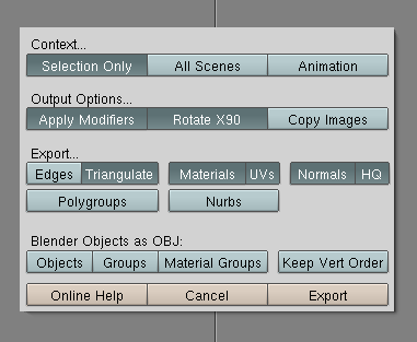

Hi. I'm trying to test some scenes with Octane demo.
On simple scene (like Cornell box) - everything OK.
But with bigger (~50-100 mb) Octane crash.
Linux Mint 8 x64, Gnome, GeForce 8800 GTS 512. Scenes converted from Blender 2.49b
...ups it can't load 6.1 mb scene! Simple Kitchen...
I can't attach it - too big?

Yaroslav_L wrote:Hi. I'm trying to test some scenes with Octane demo.
make sure you're using the correct export options, enable vertex normals and HQ, enable triangles and disable nurbs etc...
also make sure you don't have any spaces or non-latin characters in your filenames or paths.

Thank U Radiance. It not help me. Where I can read about "etc" of Blender exporting?

radiance
Posts: 7633
here you go,
also keep in mind you're GPU does not have a lot of memory to support big meshes.
Radiance
