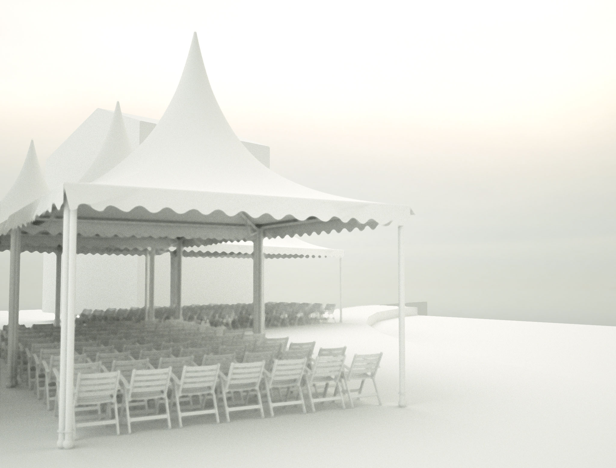

following Tugpsx advice I did an "occlusion" pass, actually a clay render of the model, add it as a multiplier to the final image, and I lower its intensity to match the shadows on the enviroment, the result is quite subtle, but I like it better, little and subtle details are what makes our "reality".
clay pass, I do love the look of the models in clay mode, it's clean, like untouched snow... it's almost zen

Well, I'm sure Radiance could clarify it, but as far as I understand it, a directligh plus a white enviroment with clay model would be the closest to an oclussion pass , a pathtracing with an actual enviroment (or with a lower gamma to get a white background) or sun and clay model should be the shadow pass, so if we play with both we should get the two different passes. I'll try it out.
