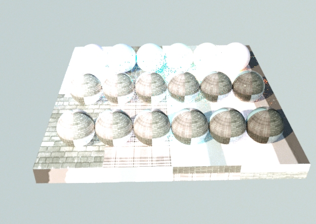

Here is how it rendered out.

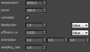

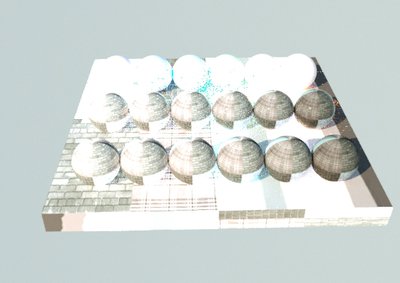

meanwhile... this all looks extremely strange; i'm too really curious what is causing this. to me all your renders look like there is a notable amount of ambient light - even if you only used this single emitter plane. just for the records, can you post your blackbody emitter settings (power/normalize/distribution/efficiency)? another thing i can not understand are the camera settings; in the first screenshot you have posted, your camera shows a focal depth of 49 meters (with autofocus on). that already sounds a bit weird to me ;)

For the most part this is happening with ambient background ambient lighting/daylighting/blackbody lighting under any and all settings thus far that I have tweaked. I'm pretty sure it has nothing to do with the settings for the camera settings, (which in my early 'what the heck' moment, I was tweaking to see if anything else was off. For the moment if something looks strange, it was not intentional). Even with the scene that was just provided to me this seems to be happening with no modification to the settings.
As for the blackbody setting for the original scene:
