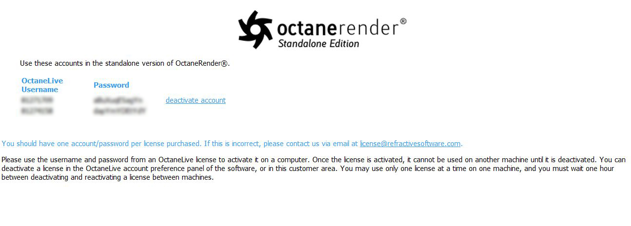

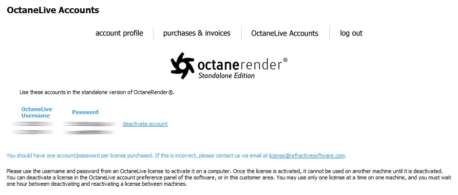

Bechstein wrote:Yes. There are two standalone accounts. Maybe that's the problem.
Yes, you need a license for OctaneRender for 3DS Max. They are separate licenses.
Roeland
Bechstein
Posts: 3
Joined: Tue Jun 01, 2010 10:06 am
That's clear. But today i bought a license for the max plugin.

rob72inmo
Posts: 38
Joined: Thu May 27, 2010 11:39 am
Same problem here i clicked to purchase the plugin and its showing i have 2 octane licenses not showing one for max
