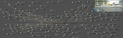

niuq.cam wrote: Sometimes or very often, the nodes intersect :mrgreen:
I put them in order and i close Octane
Perhaps, i add a new material and... :evil: and everything is a new mixed...
(only the threads, i mean, the nodes are correct)

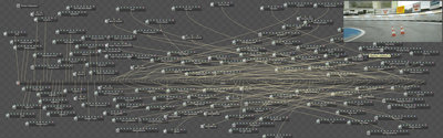

The reason is that if an object is hidden or deleted, the threads intersect. See pic 2.
If the objet was hidden and reappear, eveything remain in order.

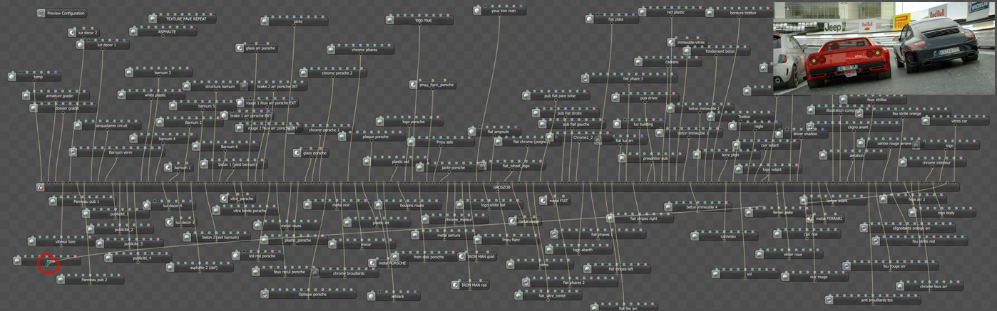

Its clear with the cone. See pic 3.
This functionning well because of the tip of bepeg4d.
"I usually create a single poly object far away or under the ground plane and i duplicate it for the numbers of materials in the scene and assign one material per poly. in this way there is always all the materials in the scene also if you hide one o more object during the animation."

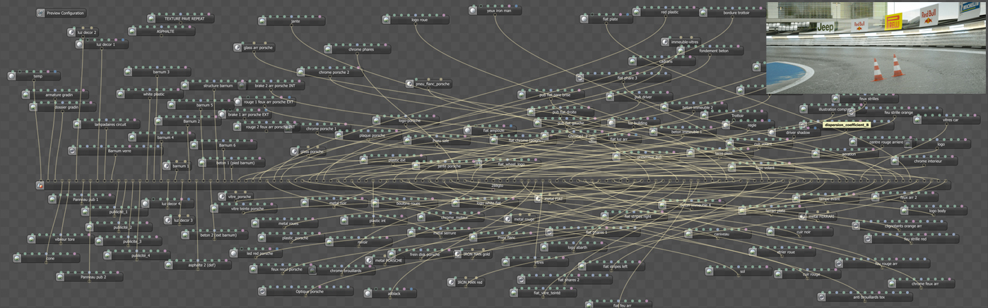

If not.
the nodes are removed purely and never get back. (but are not deleted :roll: ) See pic 4.
This is for c4d users.
Hope will help you. :D
Niuq.

I don't know what's the topic, but these screen captures prove the node system needs a serious redesign. It looks pretty with four or five nodes, it stinks on more complex scenes.

And I thought I have a mess in the graph editor.. :shock:
GE needs a lot of workflow improvements (requests for it are all over the forums) and should be the next thing RS starts to work on.

"The reason is that if an object is hidden or deleted, the threads intersect. See pic 2."
Another reason is if you assign an existant mat to a new object. :roll:
Nodes doesnt like changes...
