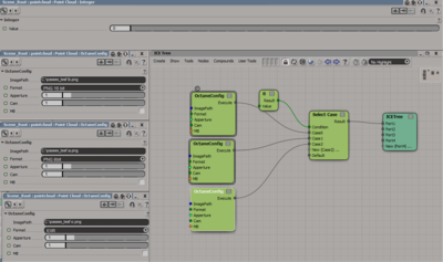

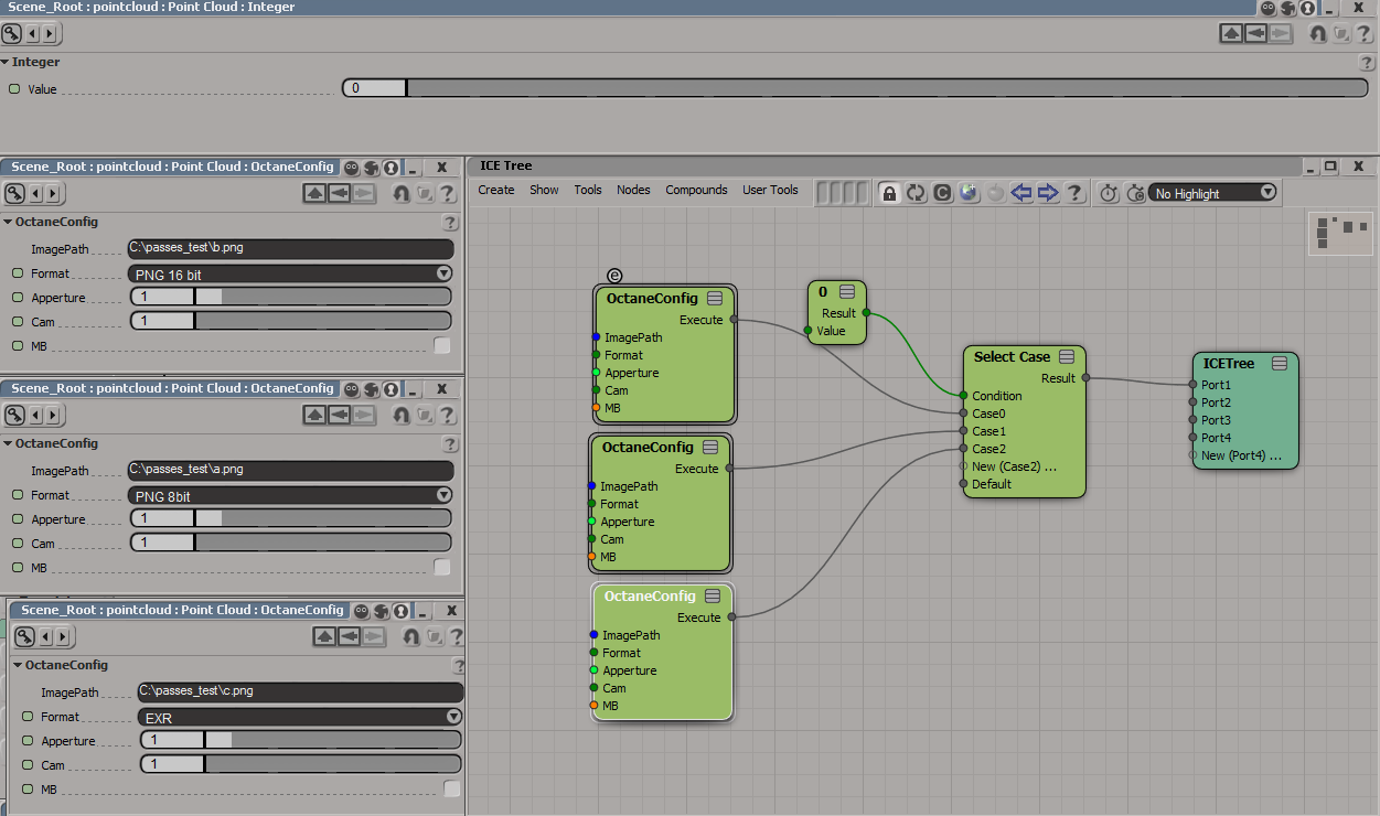

Meanwhile, for other dummies like me: you can easily have multiple Octane configs via Ice. See the attached image.

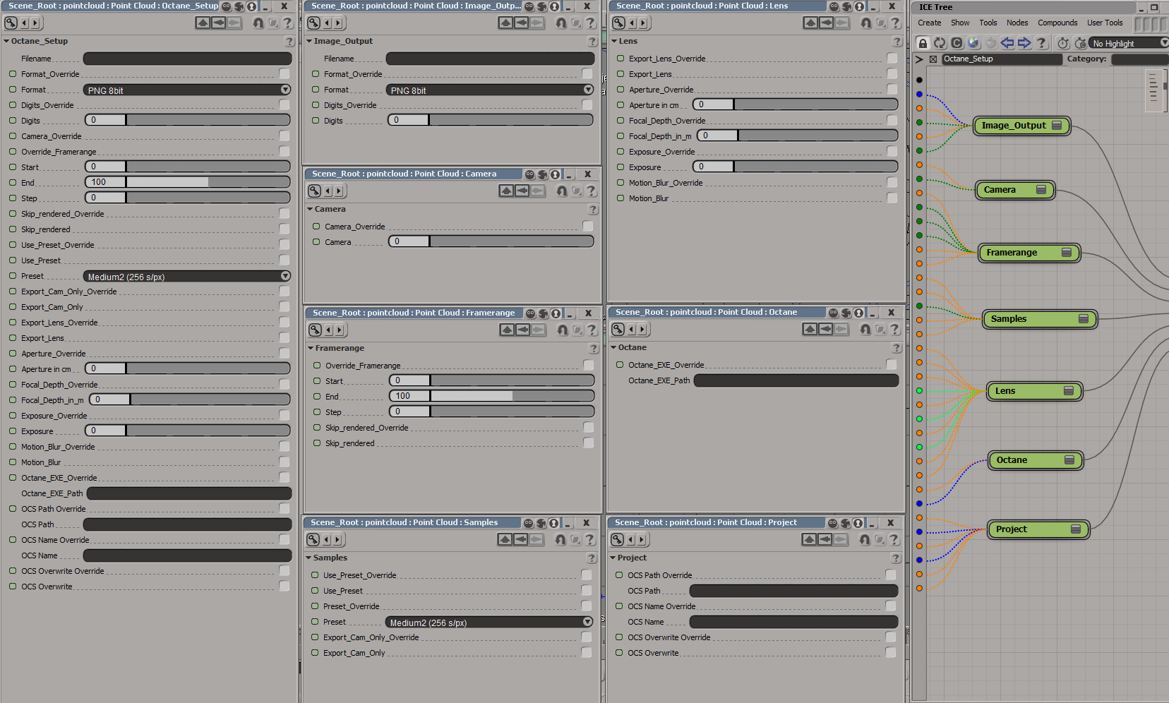

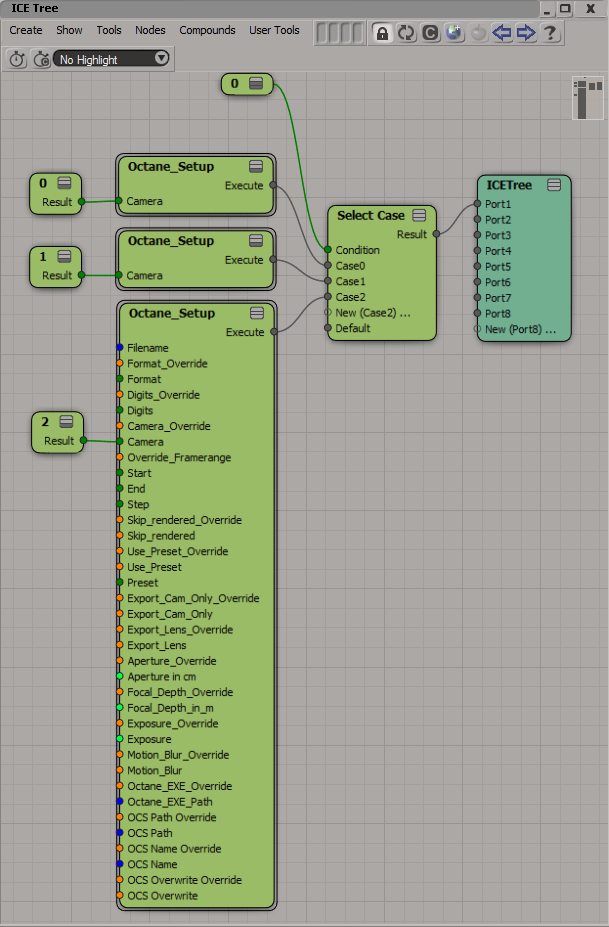

						I made a compound that allows to override any setting of Soft2Octane.
You can turn overrides on or off per pass, it respects the original Soft2Octane settings.
Combining this with Select Case you can have as many setups as you want,
so you can for example set up one scene to render:
- to different folders, with different names, frameranges, samples, etc
- from different cameras
- with different OCS
- with different Octane versions
- with different GPUs if you like (i think)
It's not finished and quite cumbersome, but it works and you can customize it any way you like.
It's extremely easy to make, but a bit time consuming.
One thing i couldn't figure out is how to make an actual camera dropdown list.
I will post it tomorrow (or rather later today). I want to clean it up a bit.
Cheers.

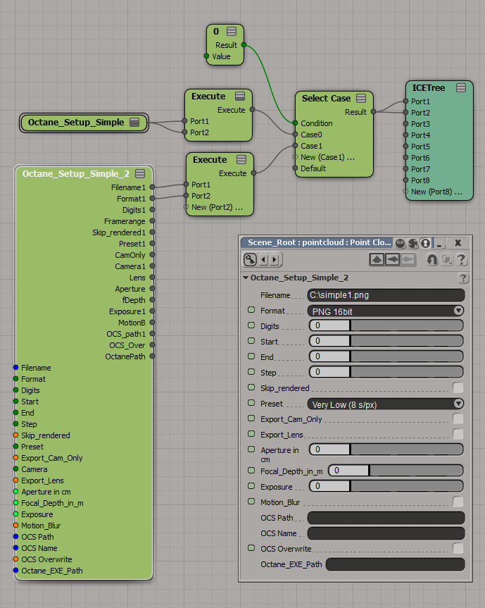

						This is a much simpler setup. You just plug the overrides you want to execute ports.
But... somehow it breaks when overrides get disconnected and from frame to frame.
Everything that's inside now are SetData nodes.
Any ideas why that could happen?

						Now i understand what you want.
You want to render different settings in one scene.
I thougt you want to render the full scene and then render the same with other settings.
Hm, i have no idea why the connection break sometimes.
Maybe some values are better to overwrite with an expression.
It´s also possible that some values aren´t set correct when you slide over the timeline, but at rendertime it should work.
