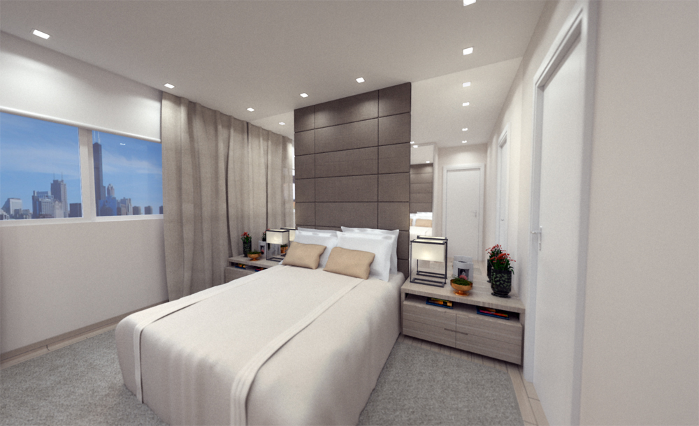

Hi Guys,
I´m Getting some difficulties to set ambient Occlusion with 2.52 version.
Daylight is giving me problems too.
Can someone please help me to understand how to set ambiente occlusion? By the way... Someone recomends to use ambient occlusion with color render made with pmc?
Here a first image using pmc.
Thnks For Help!
Regards,

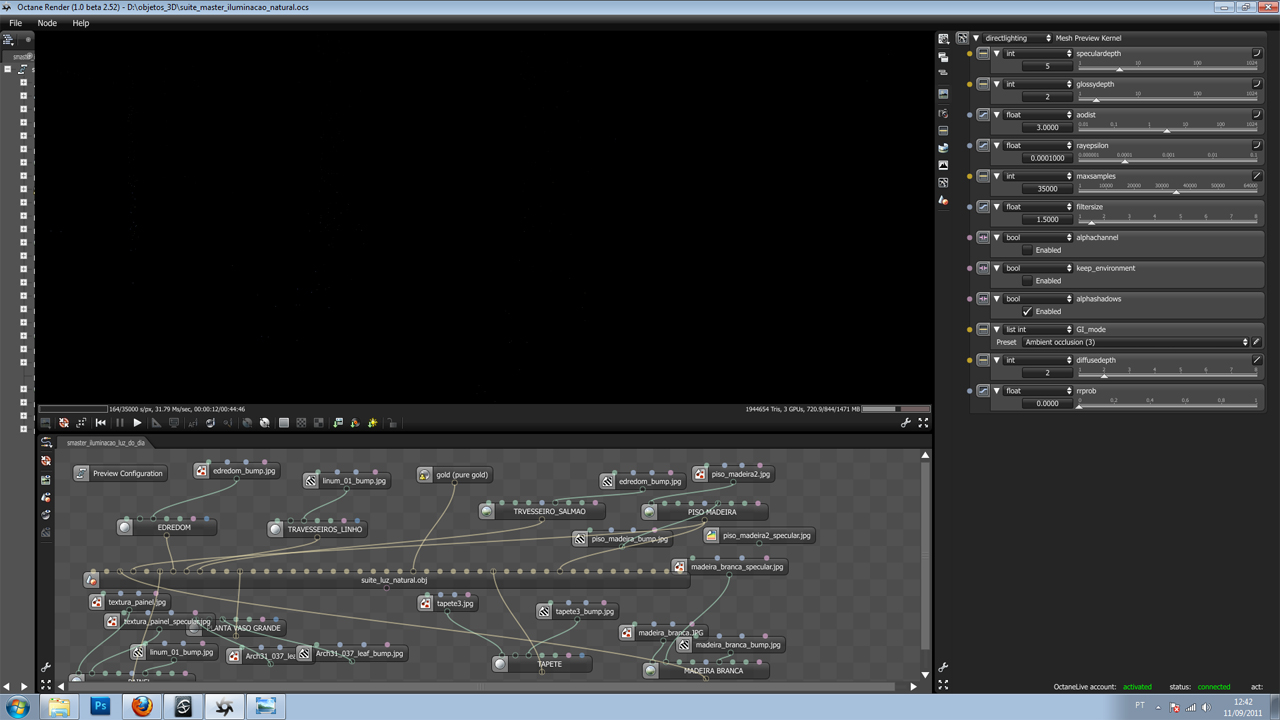

Here is a picture.
I´m using the same way i was using in 2.46
But AO stays like this.
I think something have changed, but I don´t know.
Thnks for helping me!

are you sure the scaling is correct? try decreasing the AOdist to see if something appears, if your scene is tiny and aodist is set to 3 meters it's gonna be really really dark...

vagos21 wrote:are you sure the scaling is correct? try decreasing the AOdist to see if something appears, if your scene is tiny and aodist is set to 3 meters it's gonna be really really dark...
Hey Vagos, you were right! I decrease Ao Distance and it works...
So I changed my octane exporter to centimeters and everything gets normal!
Thanks!
