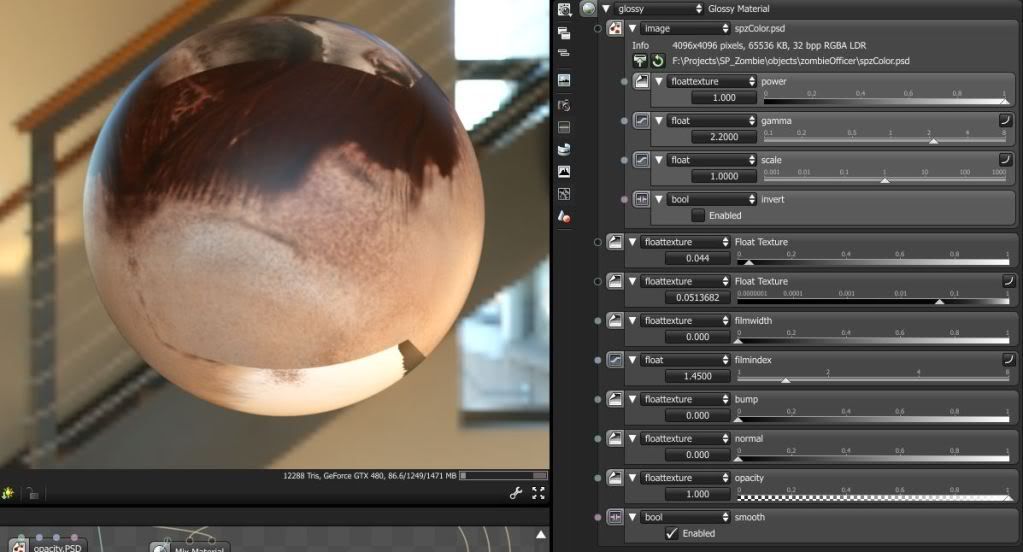

SPzombie/WIP, sculpted and textured in Zbrush, decimated for Octane, PS's been used for merge 3 renders and signature, pure octane render, texture, specularity and bump maps.
The main problem is the skin shader, with glossy material and its energy on color surfaces. The bounced rays always strive to white or black with strong roughness.
Also reflection fresnel is still here, would like to have control over it. I found that control glossy material through map is a bit tricky, in general.
The 2nd problem: insufficient energy through glossy materials. The inner part of eye has the same material as teeth, but as I mentioned already, the lighten material is losing its energy power to easy.
These problems may be the result of my lack of knowledge and just don't know how to do it :twisted:

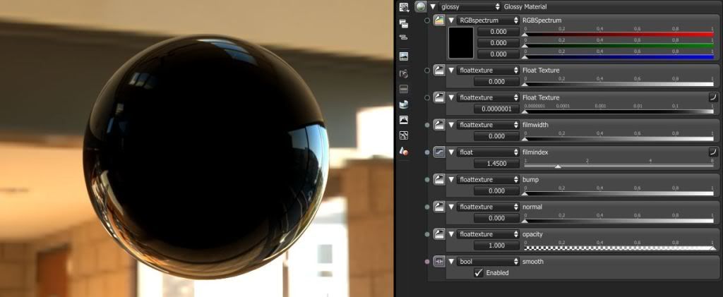

The glossy material uses a physically correct BRDF for layered paint/varnish type glossy surfaces.
Therefore it's not always correct for these kinds of materials...
Manual control over fresnel kinda breaks the physically based philosophy of the engine, and would produce a lot of completely wrong results with the untrained... therefore it has'nt been on high on our priority list, but we'll definately add it in the near future.

If so, what kind of materials were the point of reference to determine the smallest value?
Simple Test scene: sphere with black specular material. Slider goes to zero.

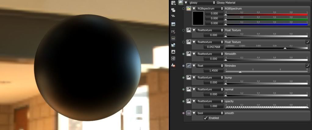

Now, lets try to add strong roughness.
...and try to achieve something looks like a skin.
The specularity of this material is still to high, but adding more roughness causes a black contour.

This is how our glossy BRDF works, as said it's meant for varnished / substrate type surfaces, not meant to be used for skin.
It always shows glossyness, even with the specularity set at 0.
A way you could try to add a pseudo SSS like effect is to use diffuse transmission.
Create a diffuse material node and connect a colour to it's 2nd (unconnected by default) input, to turn it into a diffuse transmitter.
If you place another mesh inside with a dark grey reflectance and reddish diffuse transmittance,
it could work, provided you can place a mesh inside that is say 1-2 milimeters below the surface (like a russian matroska doll)
Even more than one (in the matroska doll way) could make a better effect still.
Until SSS comes along, this is the best alternative at this time.
