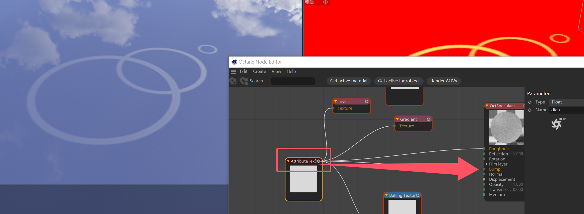

Hi, I want to know why the attribute connected to the bump channel is not read, other color roughness can be recognized, and the baking node is not working. If I did something wrong, please tell me (I don't want to bake the vertex map animation into a sequence, I want to adjust WYSIWYG directly)
Posts: 10645
Octane Baking node cannot work with geometry texture nodes, like Falloff, Dirt, Curvature or Vertex Maps.
You need to use C4D Bake tag and bake the Vertex Map into a B&W texture.

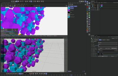

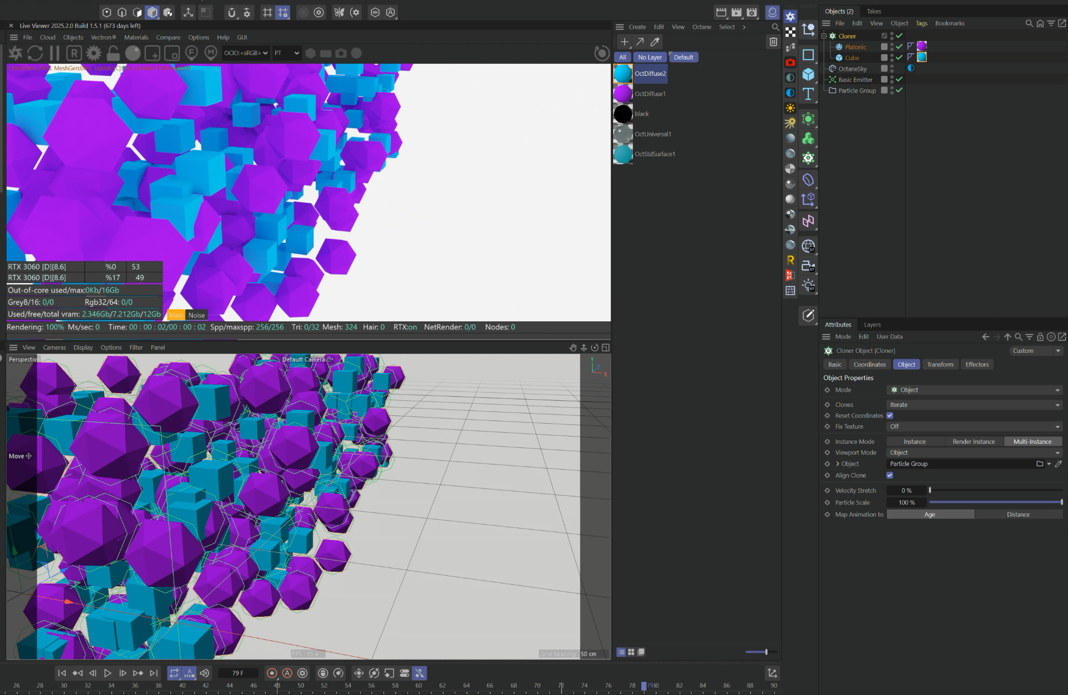

Getting crashes when adding multiple objects to the particle rendering tab. Also when it occasionally doesn't crash it will only render the first object in the tab and not cycle through the objects.
Unless I've missed something with how the particles now work.
Scene attached.
test_.rar
scene file
(370.19 KiB) Downloaded 136 times

protokol wrote: Sun May 25, 2025 10:07 pm Getting crashes when adding multiple objects to the particle rendering tab. Also when it occasionally doesn't crash it will only render the first object in the tab and not cycle through the objects.
Scene attached.
I found the issue, and the fix will be part of the next build
Posts: 10645
In the meantime, you can use a MoGraph Cloner in Multi-Instance mode:

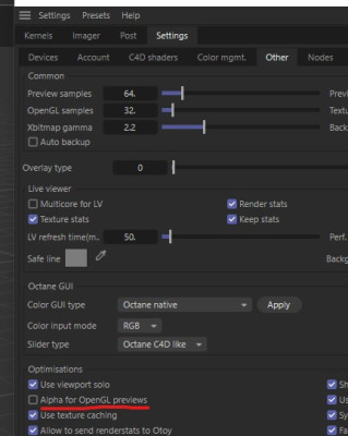

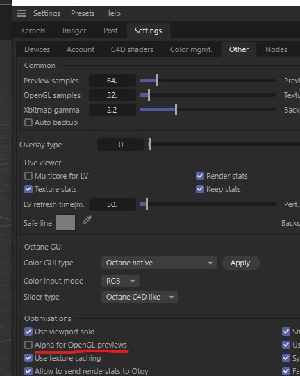

Thanks for your reply. I also noticed that the Chaos texture node has been very slow and stuck in real-time interaction since it came out. I want to know why it takes up so much performance.
In contrast, the built-in Cell bombardment node in UE5 only takes some time during compilation. Once compiled, adjusting parameters and drawing vertex colors for masks are smooth.
ChrisHekman
Posts: 1166
Joined: Wed Jan 18, 2017 3:09 pm
MyDearestHao wrote: Wed May 28, 2025 12:20 pm Thanks for your reply. I also noticed that the Chaos texture node has been very slow and stuck in real-time interaction since it came out. I want to know why it takes up so much performance.
Octane has made a change to the Chaos texture that causes it do a render to texture and cache the results. It does this when when it is not directly connected to a Image (a node with a texture in it) node or when the chaos node uses certain settings.
This render to texture blocks the thread for about 2 to 4 seconds. This would normally not be that bad, but the node editor triggers previews a lot, and every time it does a preview it will recreate the Chaos node in octane and render it, which will cause render to texture again, which then causes a block.
In the meantime you can reduce the issue sometimes by turning the Alpha for OpenGL previews setting OFF. (This setting causes frequent preview rendering due to a bug)
