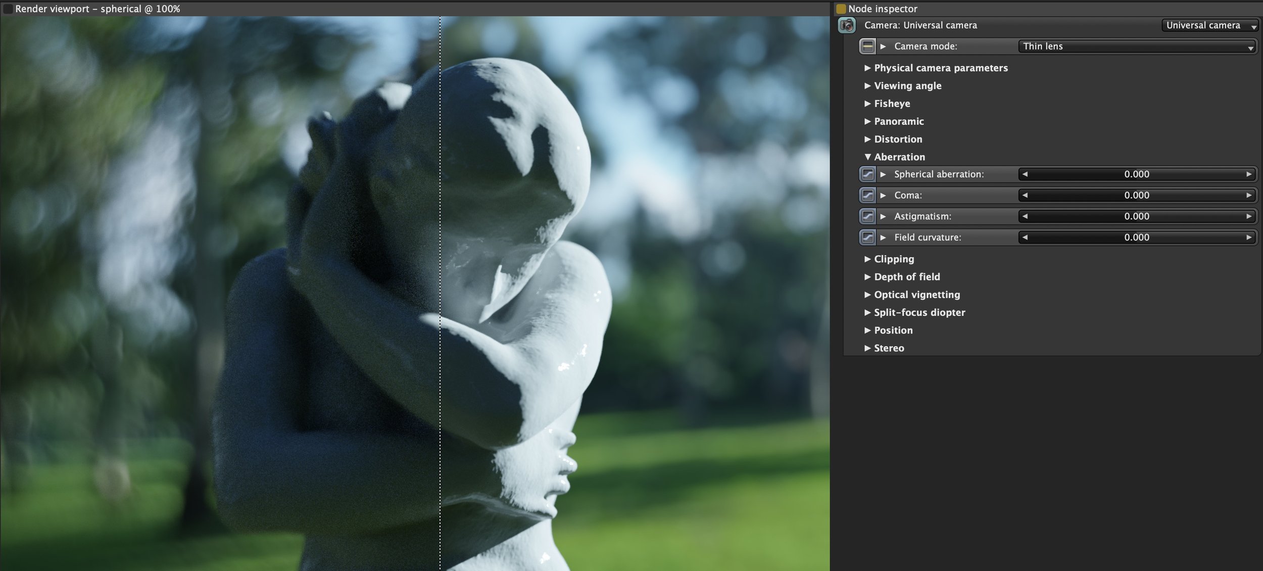

Is it possible to build custom Realistic Lens presets ?
Lens "bokeh" (out of focus aesthetic) is user-customizable via the Octane's Universal Camera (Thin Lens). Here's an introductory page (under overhaul).
This is a still from the video available on the suggested link. Modern to "vintage" lenses are achievable with solely the Universal Camera.
Furthermore, 2024.1 introduced a new camera designated as "Photographic lenses", the look-controls are near non-existant since it is a hardcoded simplified implementation of real lens optical design / models (the list contains the names).
Project files and assets on the website will be made available for download once updated.

Does that mean the Realistic Lense is "only" the Universal camera with predefines presets ?
Good question.interelectronix wrote: Sun Apr 13, 2025 3:43 pm Does that mean the Realistic Lense is "only" the Universal camera with predefines presets ?
Short answer and assumedly, no.
It doesn't appear to be,
until a developer or team member disclose that information,
it is seemingly a manual implementation of the listed reference of distinctive optical designs.
The Universal Camera features (more than) enough options to get close but unlikely to match 1:1 (which, if so, would affirmatively answer the question).
The listed lens references (optical design) are more sophisticated than what the already-impressively-sophisticated Universal Camera options provide.
It's as close as the physical lens it can get,
minus the results of coating + internal reflections (flares, veiling glare, MTF, thus contrast, and other optical properties).
PS: the "Realistic Lenses" feature a "ray-traced" Chromatic Aberration single-slider parameter.
