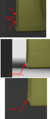

I'm using the render layers to separate the objects from the shadows. When I render the scene, it has weird artifacts in the edges (see picture attached)
I exported the render as a PNG RGBA, also TIFF to see if that was the error. I tried incrementing the samples from 2000 to 4000 and the same.
When I'm in photoshop, that layer has like a white border. In the viewport everything looks fine.

Neither Blender or Octane are faulty. Besides the Keep Environment "edge case" (discussed here).
Here is a previous case
And here is more information on alpha / export
Finally, more on sampling / kernel settings.
