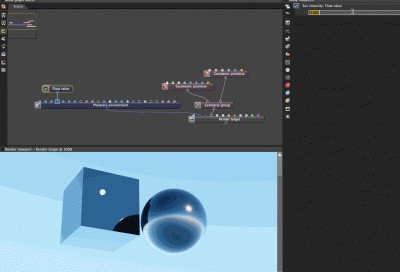

skientia wrote:It is somewhat possible in-render:
Well i dont use the standalone renderer (i need to keep into c4d environment)... I can put some values (like sun size or intensity) to 0, but that ruins the whole ilumination setup also.
Still, having an option to hide the sun globe in the sky reflections would be an useful addition, for me at least.
