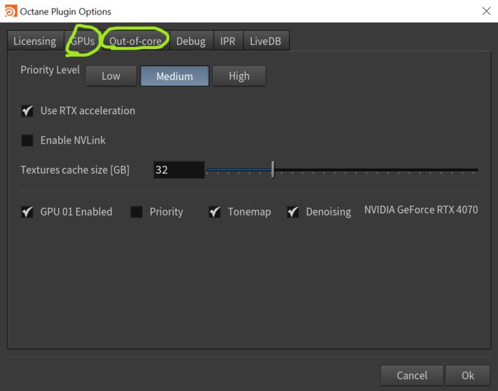

Can you also compare your 2 machines, the settings you had and if they were the same.

ricky_otoy wrote:Can you also compare your 2 machines, the settings you had and if they were the same.
Everything is usually on default there except for "Priority Level", I always set it to "High" because I don't like when only 80% of the GPU is used by Octane. 1000% t's not overheating issue lol, Octane is pretty stable with the denoisers off, Intel denoiser is more stable btw if I compare them atm.
AND DON'T FORGET THAT I TURN OFF "DENOISE ON COMPLETION" OPTION FOR THE DENOISERS TOO. They are a little more stable with that option on btw. But they are still unstable compared to 2023 which works great.
The attachment settings.jpg is no longer available
Could you try see if you can get us the following info?
When you get a crash have a look at
Code: Select all
C:/Users/<user.name>/AppData/Local/Temp/houdini_temp/
Also could you look at your Windows Event log and find the corresponding Application error, like the following:
