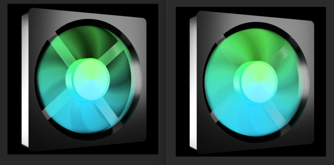

On the right is my render as it appears in c4d. On the left is the image as loaded into photoshop with a black layer then inserted behind the render.
Is there any way I can get octane to take the brightness of an object into account when generating the alpha channel? It seems as though octane is thinking "that fan blade is only present 50% of the time, so I should make the alpha channel 50% solid" But this doesnt consider how the object visually renders.
This issue causes me problems in many projects where a bright object goes from sitting in front of geometry to being in front of an alpha background. As soon as it moves from being in front of a black model to the black background, the brightness often lowers significantly because of motion blur.
Project attached.
The closest I can get is disabling "partial alpha", but then of course all my alpha channels turn into binary on/off.
holding object brightness with motion blur

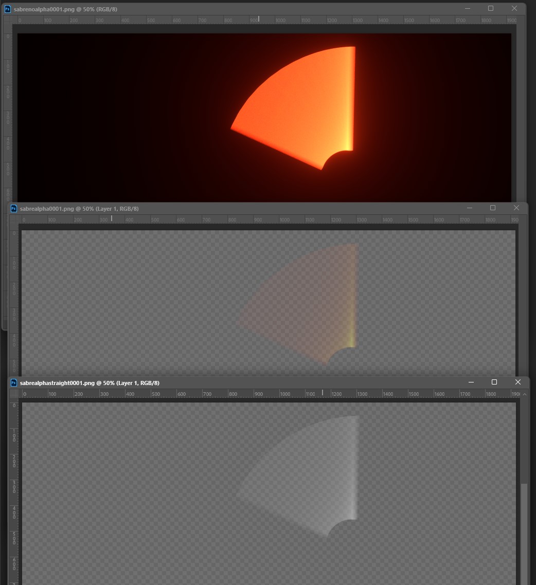

In fact here we go, lets try:
Top, lovely swooshing lightsabre exactly as I want it rendered with a black object behind it, or with alpha disabled
Middle, premultiplied alpha on, 90% of my sabre is gone
bottom, straight alpha, screwed up colour profile, as it has been since octane 4.0, useless.

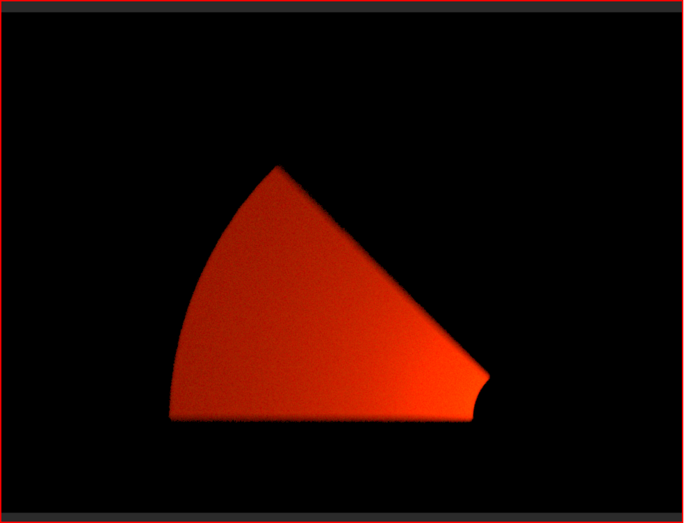

No, I would NOT expect a bright trail behind a light saber in the way you have depicted. That is not how photography works. I would expect something like this, which is exactly what I get at 24 fps with a 180 degree shutter angle.
If you want it to be brighter as it is swooshing, you need to make the emission intensity higher. You'll also need to mess with your before/after sampling, because in the real world, there isn't going to be a bright line anywhere inside the swoosh unless the sabre was motionless for part of the exposure. While motion blur is often depicted that way in comic books and such, that's not what it looks like on film without intentionally making it less realistic in post or by manipulating the exposure.

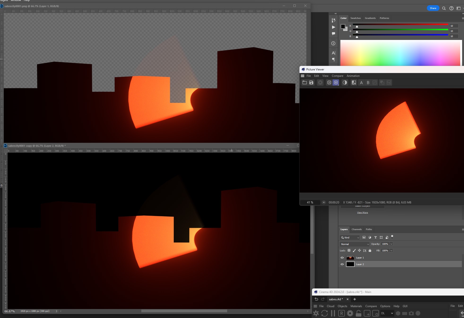

Here, maybe this will demonstrate the problem more. I have my lightsabre fight, its taking place at night against a city scape in the background, all youll see are the sabres and some foreground light they cast, ill be comping the night sky in post.
Image on the right, my render, a nice full swoosh, no problems
Top left image: how it loads into photoshop. the sabre in front of the buildings works fine, as soon as it goes in front of the sky, the motion blur obliterates the object regardless of its brightness
Bottom image: i stick a black layer behind everything, the sabre aint coming back.
