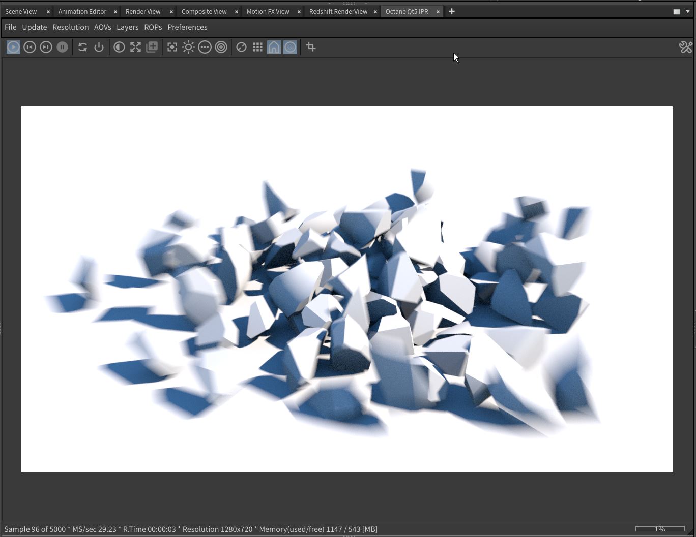

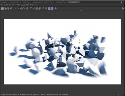

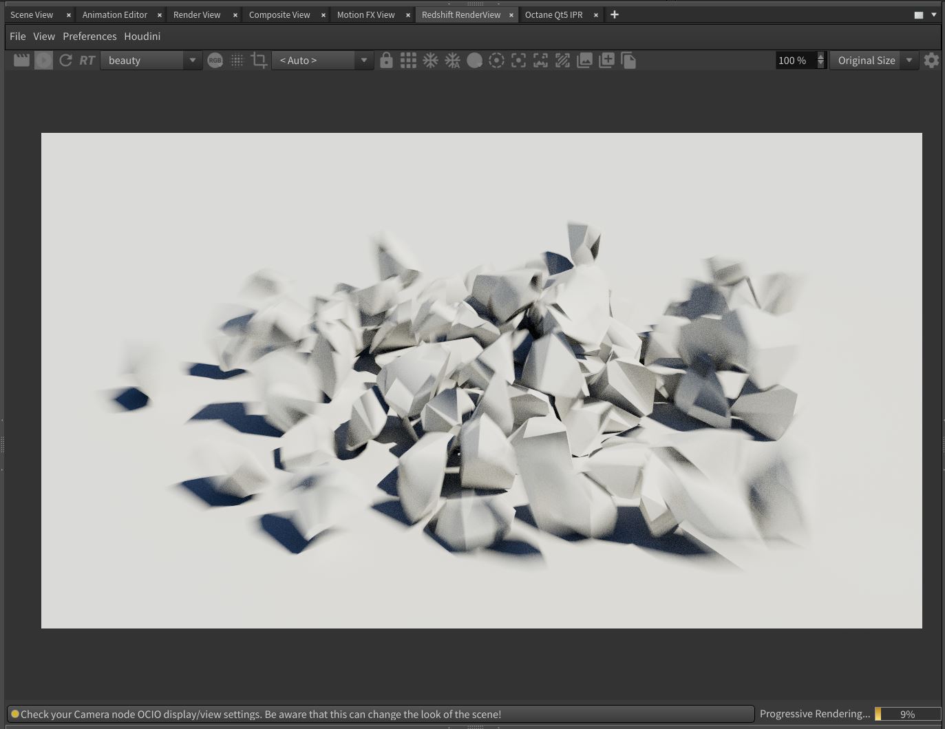

Yep, I'm not sure what's going on with your scene. I've been testing a simple rbd fracture scene here that includes packed fragments and both the scene extraction time and rendering times are the same in Octane and Redshift. In fact, Octane is a bit faster.
I'm going to need your scene to try to find the problem.
Thanks,
-Juanjo
