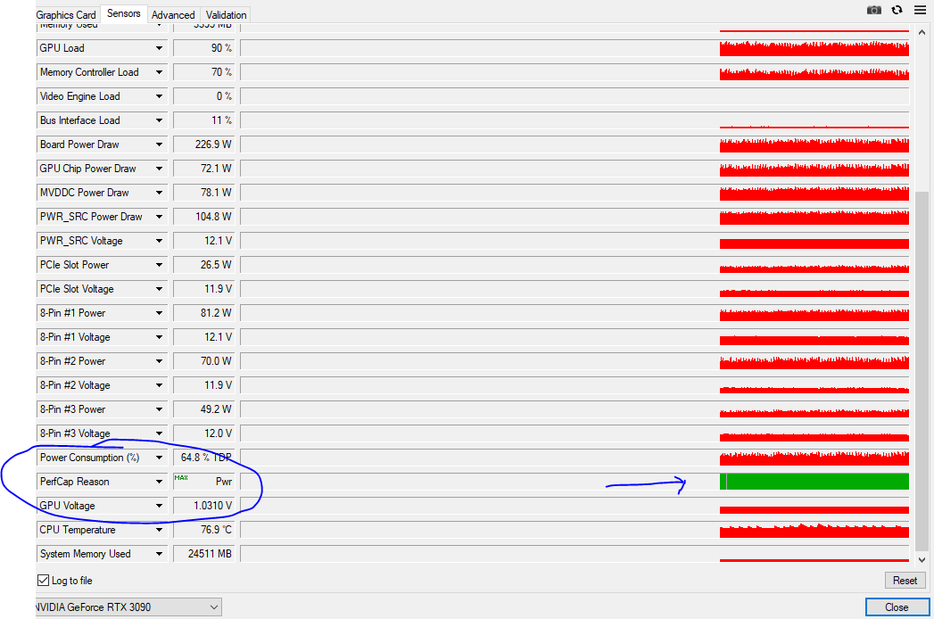

I just ran GPU-Z and noticed the PerfCap Reason says Max Pwr - so that means the PSU is over powered?

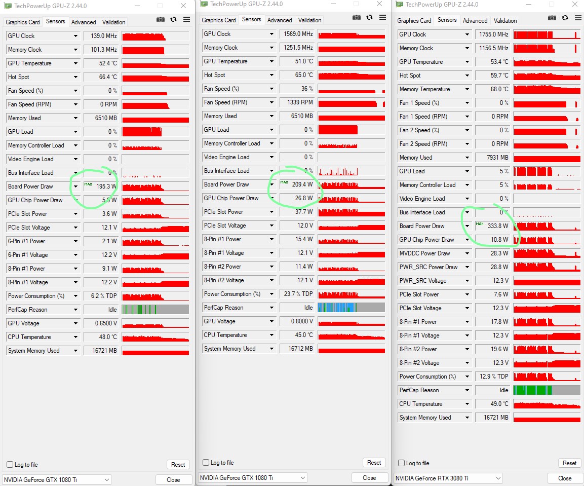

I had a similar problem that my PC would just cut the power while rendering after upgrading 1 of the cards to a 3080Ti.
I have a Corsair 1000 Watt PSU running 3 cards. 2x GTX1080 + 1 RTX3080Ti all factory overclocked. Now and then it would cut the power while rendering, so I under powered the cards with EVGA's Precision X1. After some trail and error the cards are now under powered from 100% to 70%, 73% and 90%. I haven't had a shutdown since then. And I strangely enough didn't loose that much rendering speed. A 2 minute render is now 2 minutes an 2 seconds.
Start 4 GPU-Z programs and set them to monitor each card. In GPU-Z check the "Board Power Draw" and set them to "Show highest reading". Then you can see how much watt each card draws. It's the spikes in the power draw that will shut down the PC.
You can adjust the power for each card with Precision X1 - or as you mentioned maybe with MSi Afterburner but I don't know that software.
