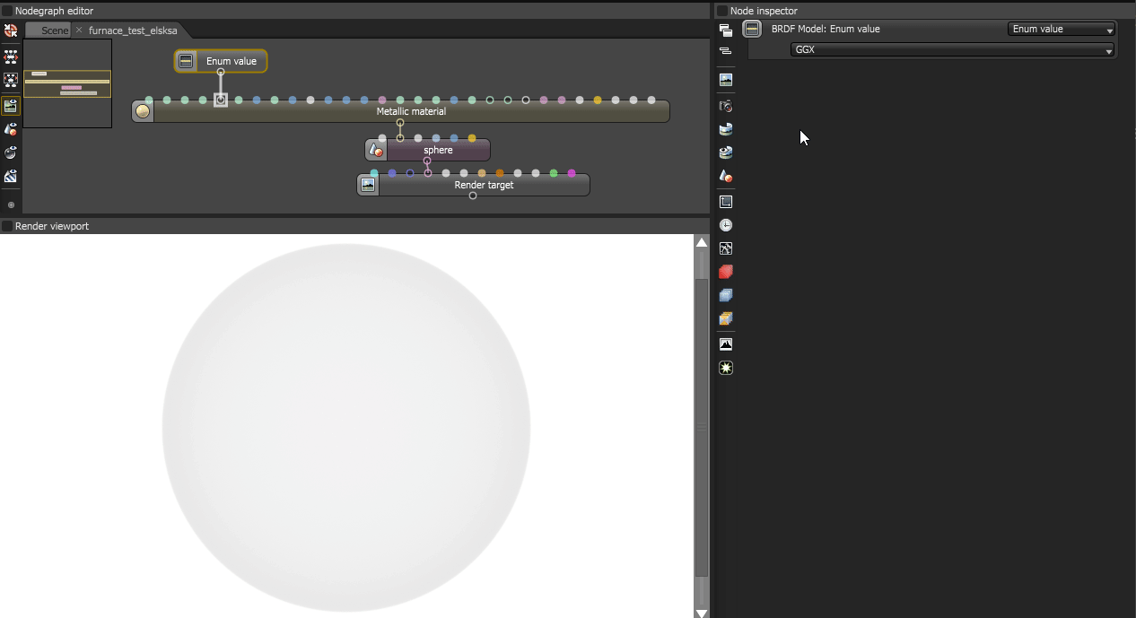

Without it, a loss of energy ("darkening" of the material, even if subtle) will occur. A furnace test will manifest this loss:
