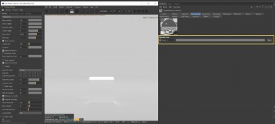

Since the 2020.2.5 update of the plugin, whenever I try to create a metallic material via Material Type: "metallic material" the reflections are non-existent.
It is created looking like a normal white diffuse material, and when I try to deactivate or set the diffuse channel to black, there are no reflections.
It becomes a complete black material. IOR settings doesn't have any effect. With the "Universal Material" it seems to function as intended. Also it works with the older way, to create a glossy material and set the diffuse to black and a high IOR, but on this way, I can't use the IOR Rgb function.

Please check that the Float value in the Specular map channel is set to 1. If not enough, please share a screenshot from Live View, thanks.

Indeed that was the case. The Float in the Specular Map Channel is set to 0 by default. When I put it to 1, everything works again.
