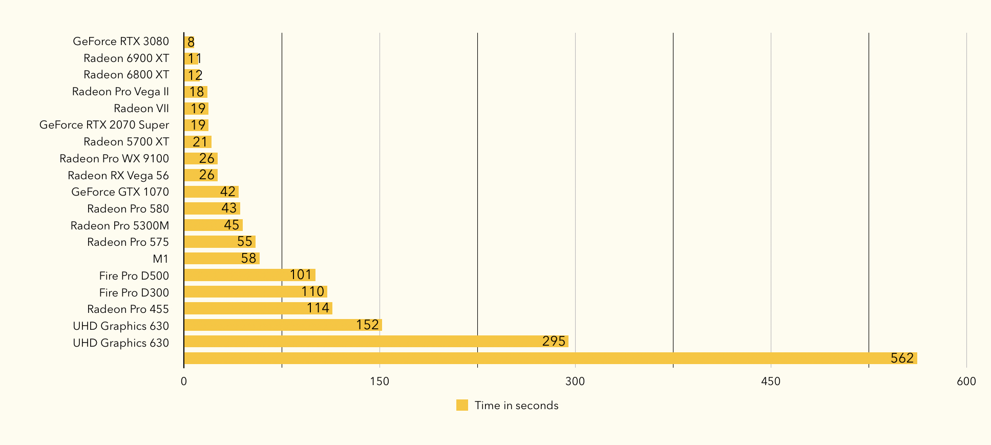

Here you can fins a test made by a Mac Pro user with 2x Radeon Pro II Duo, so 4x GPUs:
viewtopic.php?f=7&t=75411&start=730#p400159
Unfortunately we need to wait for 2021.1 stable SDK, to have an OctaneBench version supporting both CUDA and Metal GPUs, for a precise comparison, but in the meantime, we are trying to have an idea of the speed with this simple test here:
viewtopic.php?f=7&t=75411&start=700#p399724
Here is what we have found so far:
New Big Navi21 GPUs, like RX 6800 XT and RX 6900 XT, are the best option for price/performance, at the moment, even if you need to consider that they have 16GB of VRAM, while Radeon Pro II has 32GB of VRAM, so double space for scene complexity.
