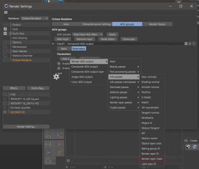

Hi everyone,
I've tried to use the render layer mask in the new AOV system but I haven't been able to make it work. Is there a place where I can find explanations on how to use it? And how can I give one number or another to my render layer mask pass if I have several objects with several numbers of layer ID ?
Thxs a lot for your explanations
Nico

the new aov system seems to be faster than the previous (usual) info passes because it doesn't have to re-calculate 128 samples or more at the end of the beauty render (as redshift for example) so i wanted to use this way to win some seconds on each frame and it seems it doesn't work for now. Doesn't matter! Thxs

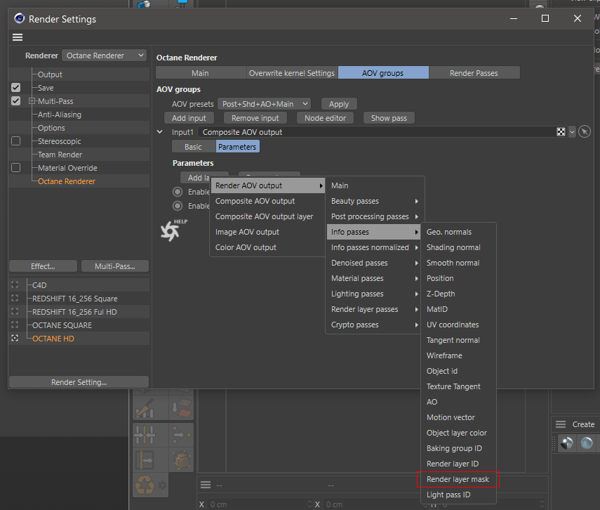

Here is a screenshot of my render settings

You'll find Render Layer MAsks in "Render AOV Group". As it was before.
Just don't run EXR (Octane) file format cause it will disapear. Use standard EXR format.
Oh and a news from today - standard EXR will work with PIZ compression but will not work with DWAA compression. EXR Octane works with DWAA, but for example Blackmagic Fusion will not read EXR Octane format. Just so we know.
