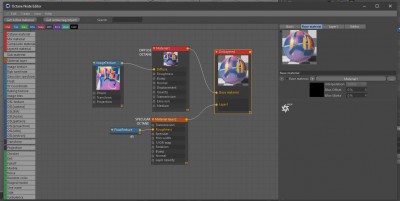

I would like to create a shader with the layer material.

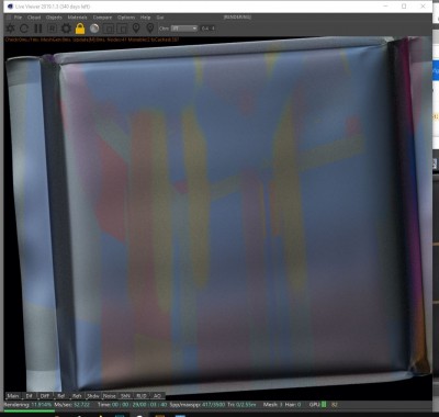

What I don't quite understand is why I see so much color in the reflection pass. What am I missing?
When I recreate the same setup with a mix material, the reflections are neutral as I would expect them to be...
What I want to create is a simple, diffuse material with a clearcoat over it, similar to a car paint.
Here is a small example:

what about the Layer Opacity of the Specular layer?
ciao Beppe
ciao Beppe

Hey, Beppe,
thank's for your answer!
The Opacity is set to 1, that can't be it.
In my example we see only the Reflection Layer.
Even if the Opacity was set to .3, there should be no color in the reflection.

Hi martin,
do you mind to share the material?
ciao Beppe
