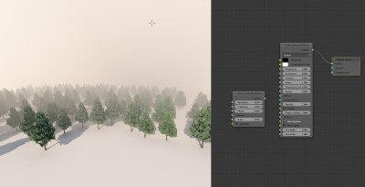

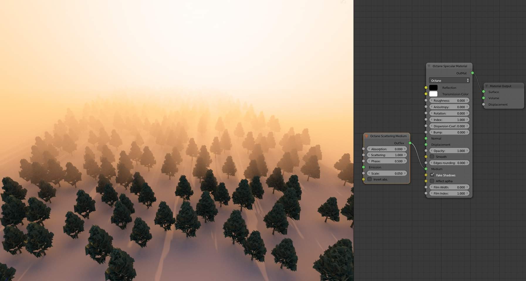

There is a cool workaround involving a simple plane in front of camera with a Specular material. The setup looks like this:
The fog can be easily moved back of forward to get desired effect

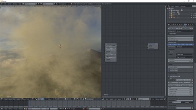

You've got to be kidding me... Tried this and within 5 minutes have sandstorms and god rays.
J.C - you are a legend.

Increasing phase setting in medium node gives interesting results:
