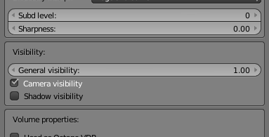

When might a developer take a look? I am wondering if the above, nested deep in Octane Properties isn't creating a conflict.
I can tell you that it drove me nuts trying to figure out why an object I could see, that was supposedly enabled in both Render and Visiblity in the Outliner,
would not Render, until I found that the primitive from which it was created (cylinder) was Camera visibility disabled within Octane properties.
Since correcting this toggle, and it may be premature, I am not seeing Render server crashes every minute or so.
Why is this function is not nested in the outliner?

The Octane camera visibility is always ON by default. Those settings are part of Octane layer system that exist in Standalone so they are also available here in plugin.
https://docs.otoy.com/StandaloneH_STA/S ... erNode.htm
