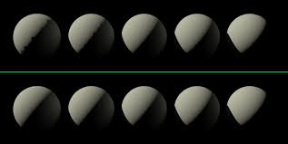

A big issue I have with this Unity/Octane marriage is how terrible Octane is at rendering low-poly assets. There are renderers out there with shading termination hacks that make for beautiful low-poly renders. Thea render, Modo, and Furryball come to mind. These renderers are optimized for lower-poly content, and so they don't suffer from terminator artifacts.
I have looked through the manual, and I can't find subdivision surfaces mentioned anywhere. How do I access the subdiv levels for my scene geometry? I think this is really important. I would like to import all-quad FBX assets and have them subdivided at render time. If I have to export these assets at high subdiv levels, that's going explode asset import times and bog-down Unity.

So I thought I would report back on a couple solutions to minimize the faceted terminator artifacts that appear on low poly assets using octane render in Unity.
The first solution is to use this free asset:
https://assetstore.unity.com/packages/t ... sion-95479
The above asset can be used to subdivide the meshes in your shot near the camera that might be causing shading issues. But even with 2 subdiv levels you still might have the dreaded terminator issues.
So the 2nd thing you'll need to do is increase the Ray epsilon in the PBR render target.
Using both these things together, you should be able to get production quality renders out of Octane Unity (for static assets at least).
My thoughts are that if this free asset can do what I asking, I think it's reasonable for Octane for Unity to be able to do this at render time. If meshes in the scene had an exposed property for subdiv level, that would be fantastic.
Also, .002 or .003 might be a better starting default for ray epsilon.
