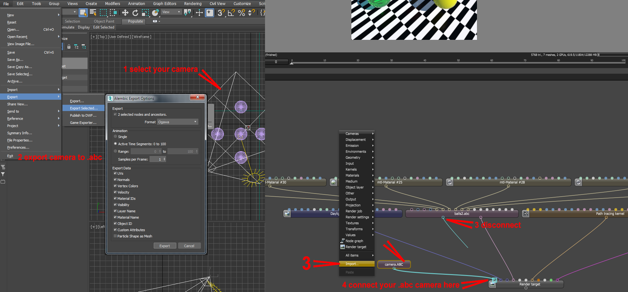

Hi BenterA,
Octane for 3dsmax 5.08 has an animated .abc camera issue already reported to developers.
Workaround is exporting animated camera to .abc then importing separately into SA.
3dsMax > export selected > .abc
Regards
Paride

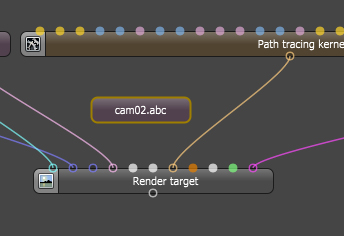

I tried to import the Camera seperately as an alembic. But unfortunately the Cam Node does not have any inputs to connect it? Do you know what the reason behind that could be?
Many Thanks
Ben
paride4331
Posts: 3809
Hi BenterA,
right mouse button select > ungroup
Regards
Paride

paride4331
Posts: 3809
Hi BenterA,
I must have misunderstood, attached a screenshot.
Regards
Paride

Thank you for you help! I have tried it this way, too. But as you can see, there is just no way to connect it.
paride4331
Posts: 3809
Hi BenterA,
