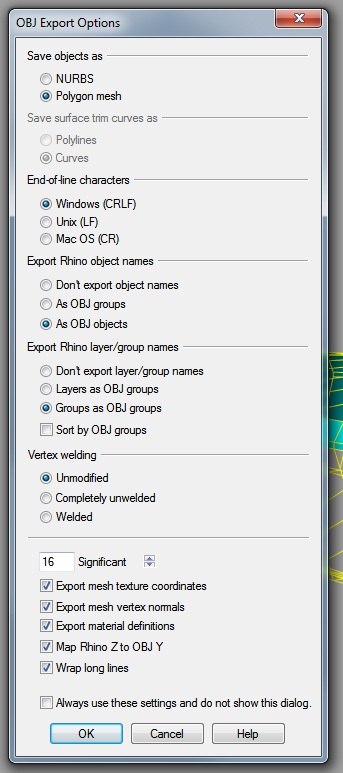

Here is a screenshot of my Rhino to Octane export settings. I usually model in feet, but if your using anything other that meters be sure to change the import mesh units to your units in the Octane preferences page. I still have to do some manual adjustments in Octane on materials, but it is not so bad if your rhino groups as OBJ groups button is selected. Hopefully Sam's export script will improve on all of this. I still have it, but I was using an older version of Octane and the script is 'pointed' at that and I'm not savy enough to re-direct it to the pre-2.3 that is currently out. Perhaps I'll uninstall and reinstall the his script and see if it can find the latest. Sam, if your reading this, I hope things have settled down for you and you can wrap up the latest script for pre-2.3. Thanks, Jody
