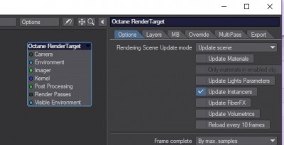

Do you have the "Update Instancers" option enabled in the render target root node options panel? If you are rendering in "update scene" mode, this option must be enabled to update the instancers animation.
In any case, if everything fails, render the scene in "full scene reload" mode should fix any kind of problem updating the scene among the frames.

That seems to be where my issue was. Thanks
