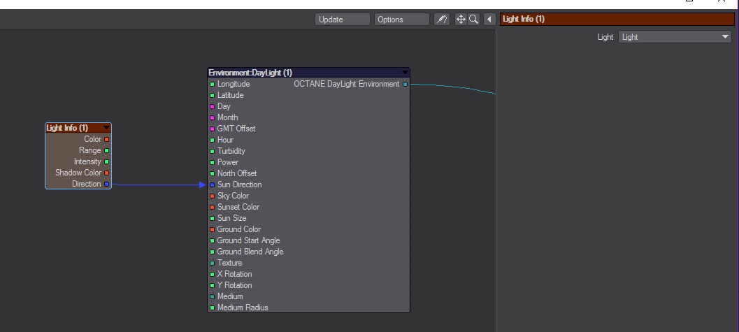

The "Sun direction" input is designed to work linked to the Light Info "Direction" output. It has some logic inside to match the LightWave light orientation to the Octane sun direction, so if you need to keyframe the sun direction you should use an animated LightWave light to drive it.
