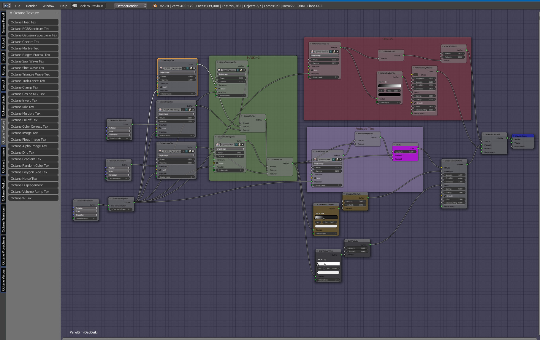

I would like to ask if is there a possibility to add some nodes:
1) Image Name/Path Feed Node - node that feeds connected Image Texture/Float Nodes with the texture Path/Name ?
2) Retransformate node - node that takes as input Image Texture/Float Node output and making a transformation ( Scale/Trans/Rot) and sets to its output this texture with changed transformation ?
Why do I need that ?
When you did that groups of nodes work ( can be feeded by exGroup input ) it gives me possibility to make own shader created as a group of nodes.
In many cases I can use (1) single image texture and make from it by node calculation additional maps as: bump, spec, etc.
If I had an Image Name feeder I could feed my texture nodes from one place.
Second case (2) is when I use a single texture ( as a wood for the tiled floor ) and by masking and transforming I crate own nice looking planked wood floor.
But here I need a post-texture retrasnformate node to change transformation for every masked part.
Both nodes could be very useful in the case that is shown on the attached screen capture of material ( that simulates wooden planks based on one plain wood texture).
I could enclose all it into one group and all those first three texture nodes I could feed form external Name Feeder.
And with Retransformate node I could replace all those three Image texture nodes by one Image Texture Node and still could make separate transformation for every forked line that goes from that node.
