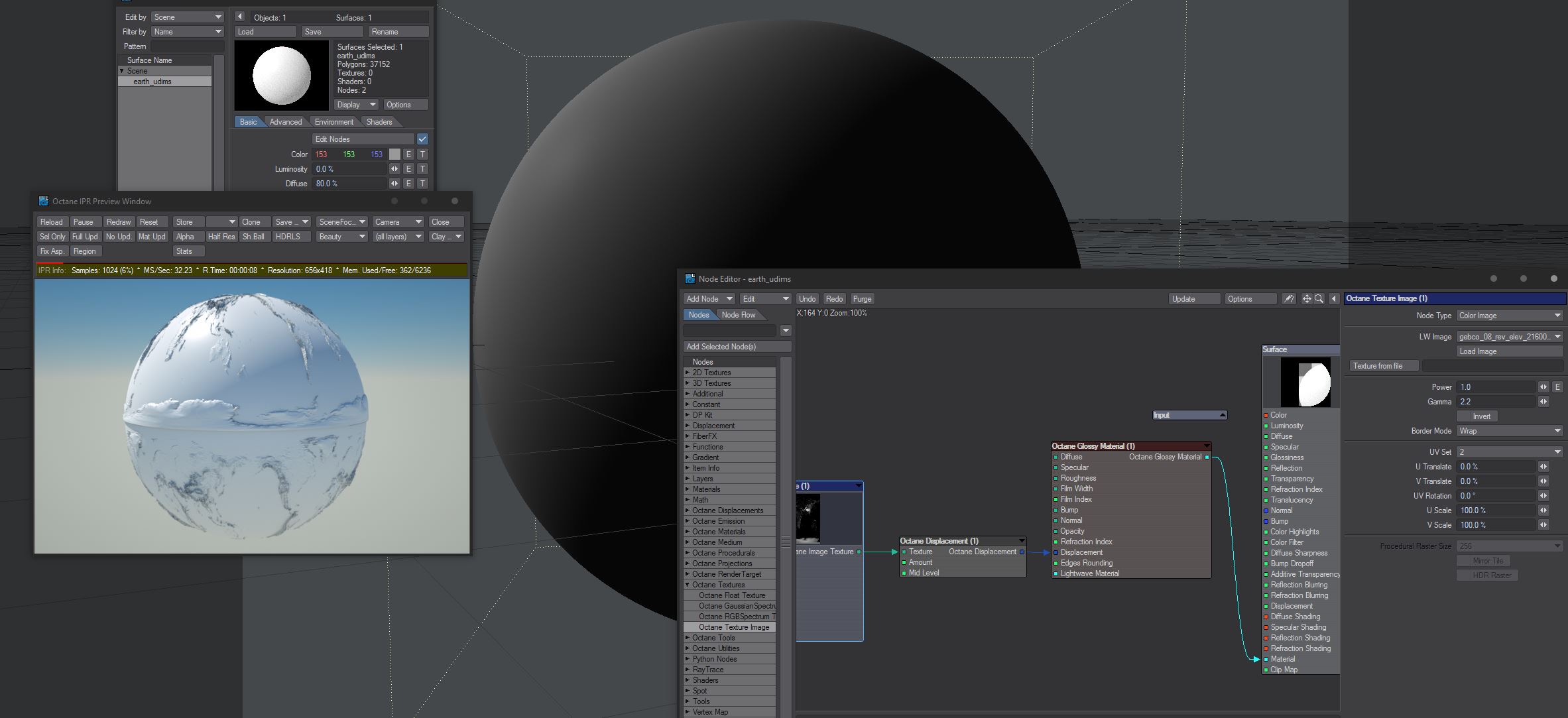

Ok, so I'm testing the same setup in LightWave as I did in Modo. To my amazement, I get the very same result.
I have a sphere which I have UV mapped in two ways: one UV set 1 is with UDIM 1-8, UV set 2 is the entire sphere in a single tile, square.
The texture map works if I apply it as the diffuse texture
As expected, when the UDIM UV set 1 is active, it doesn't look right.
Yet again as expected with UV set 2
Now: why won't it work correct when I add this to displacement? It's as if it disregards UV set 2 entirely, and does its own thing. In fact, it does not matter whatever kind of projection I throw at it. It will not change!
Modo & LightWave 3D | Win 10 x64 | RTX 2080 Ti | Threadripper 2920x | 128GB

The displacement should work with the select UV map. The Octane projections are not compatible with displacement, only the UV mapping works.

OlaHaldor
Posts: 148
Joined: Sun Jul 07, 2013 7:48 am
Location: Norway
I can assue you, it did not respond to selecting different UV maps.
In Modo I have pin pointed it down to: the displacement only applies to UV set 1, and cannot be set to UV set 2.
In my case I had made the UDIM setup in UV set 1, while the sphere was mapped as a single tile in UV set 2 - thus it didn't map correct regardless of which UV set I picked, because the displacement cannot be changed to anything but UV set 1. I have a hunch this is true in LightWave too, in fact, perhaps even Octane as a whole.
