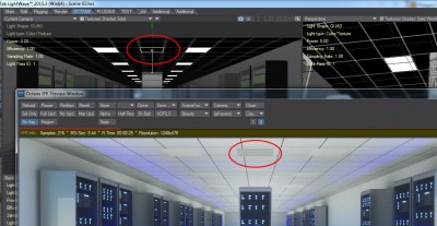

I have noticed something in Octane that I cannot seem work out.
When I use box projection it does not seem to center to the world axis like LightWave does. I have tried world coordinates and local.
Can anyone explain what I might be doing wrong?
Here is an image to illustrate the problem.
juanjgon
Posts: 8867
Location: Spain
Yes, this is known issue from the beginning. The LW renderer and OpenGL viewport cubic projection doesn't have the same origin (and other parameters, like the rotation) than Octane. The UV maps projection should match, but the Octane projections can't be exactly reproduced in the LW OpenGL viewports.

Just out of interest, why is it that it can't start a box projected texture at 0,0,0 in the world space? I'm just interested :)
juanjgon
Posts: 8867
Location: Spain
I could modify the Octane projection parameters at scene extraction time to try to match the LightWave OpenGL viewports, but the problem is that now it is a bit late, because I could break all the old scenes, and the conversion could be not easy at all.
