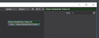

Yes I'm quite sure I click-dragged the button next to the text field to generate a seed.
I will double check when I'm back home in a few hours to confirm.

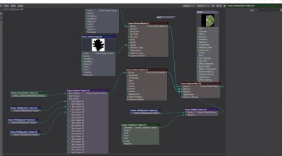

Here's a screenshot of the surface setup for the leaves.
Then I compared with another F9 render, after the shift in the animation render. The new F9 render I just performed and frame 186 (about the place where the shift happens in the video above), match.
So I'm thinking; every time I close the scene, even if I have just opened it, I'm prompted whether I want to save the object. Perhaps that does something to the seed? All though the number itself doesn't change, something does? Speculation of course. But I just cannot understand why this'd happen.
If in doubt, I can assure you I had absolutely no interest in going into the surface editor and change the seed when the animation failed to render completely in one go, and I found the only way to get Octane to behave again was to shut down LightWave and re-open the scene, edit the starting frame number and hit F10.
I performed a F9 render of frame 20 which I then compared to a frame from the animation, long before the animation render failed. They did not match.Then I compared with another F9 render, after the shift in the animation render. The new F9 render I just performed and frame 186 (about the place where the shift happens in the video above), match.
