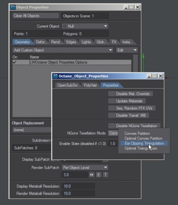

There is a new tool in the Octane custom object plugin to select the triangulation algorithm. Perhaps in your object, the "ear clipping" algorithm could work better.
