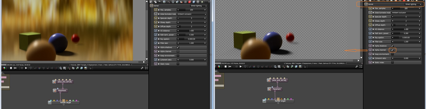

hi, the visibility options you've tried so far just works for geometry. can you try using the 'alpha channel' on the kernel settings?

hi RouseandFable, what I meant is like this over here:
let me know if that works

Thank you sir, i new it was a simple fix!
