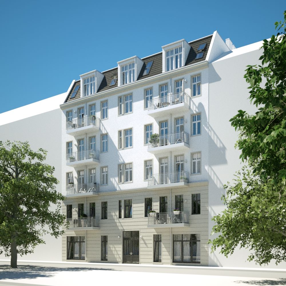

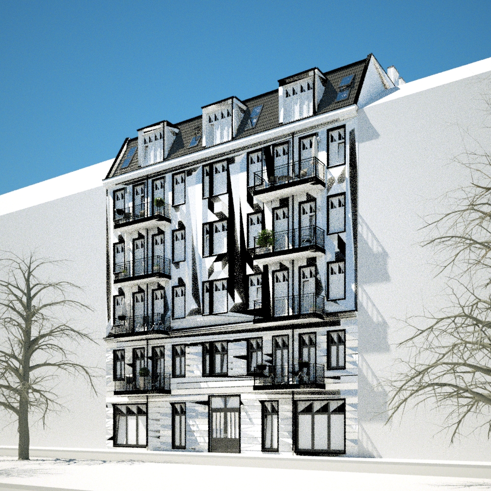

I can't send you the scene because it's huge and I am not allowed to hand it on to third party. I thought I figured the problem out in the last scene by deleting an object. After having deleted that object everything worked fine. But now I am working on the next scene and the same problem occured again. Only this time I don't have the object in the scene and really don't know what could be the problem this time. It seams to appear when a certain amount of ocjets are loaded in the render vieport and the scene reaches a certain size.
Here's what the render viewport says:
Memory: 3,713/4,929GB,
Textures: rgb 67, rgb64 0, grey 31, grey16 0
I attached two pictures. One pictures shows how it should look like (to get this picture I had to hide several objects) and one shows the error output. The error log doesn't say anything but pretends that everything is fine :?

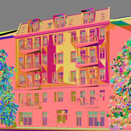

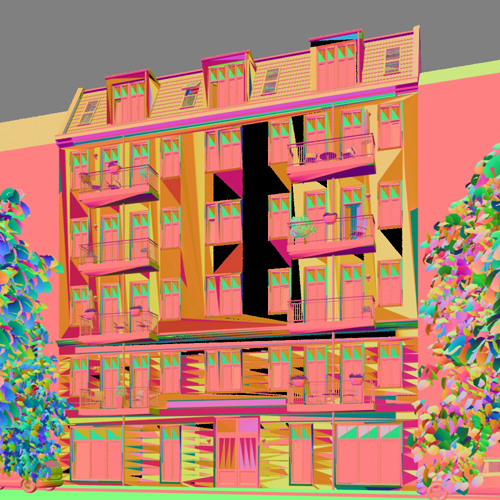

Hey everyone,

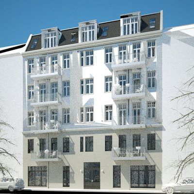

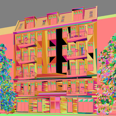

sadly I am still didn't get any further with my "texture bug". I really don't succeed in locating the error because it appears randomly and also takes the leafs away from my forests (Plants are set with Itoo forest Pack). Here is what I've already tried:
Increasing the rayepsilon value didn't help.
Then I checked the info channel kernels. The "geometric normals channel" looks quite normal to me, but the "Shading normals channel" gives a similar picture as the faulty rendering. I attached three pics, so that you can have a look: "01_error", "02_error_geometric normals" and "03_error_shading normals".

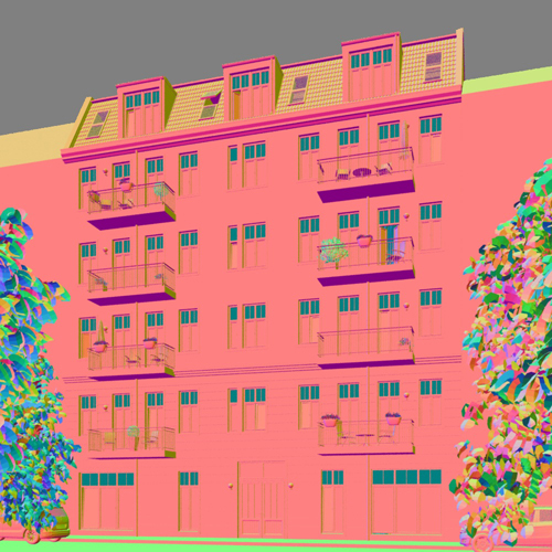

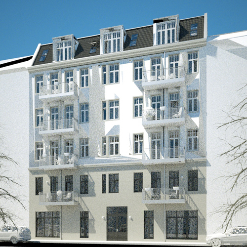

Then I found out that the error changes with making or unmaking things movable proxies. I attached another picture ("unmade proxies") to show you that the materials shown in the rendering for the front of the house and the windows are now shown differently after I unmade the belongig objects movable proxies (rest of the scene are still proxies and I also need most of them to be). I attached another two pics to show this: "04_unmade proxies" and "05_unmade proxies_shading normals".
