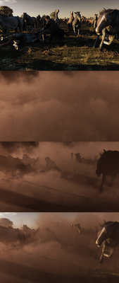

abstrax wrote:Please be aware that the render passes are not finished yet. Feel free to let us know which passes you are missing and why you need them, i.e. how you use them in your compositing workflow. Most of the work was integrating render passes into our interactive render framework, which is done now and adding new passes should be more or less straight forward.
Hey Marcus, how feasible would it be to add Deep Data support to Octane?
http://render.otoy.com/forum/viewtopic. ... 4&p=133481
What is Deep Data and how can it be used with Octane? Deep Data is a new addition to the OpenEXR format which allows you to store multiple depth samples on a per-pixel basis. It is akin to ZDepth but on steroids and without many of the drawbacks (Edge Artifacts). In the example image below you could accurately comp a beauty pass done in Octane with a complex volumetric pass rendered in another renderer (such as 3Delight, Mantra and Vray). The Deep Data stored in the Octane pass would then allow you to punch out a 'hold out' pass in the volumetric pass. That volumetric pass can then further be relighted in Nuke to match the Octane plate.

there is a positionpass allready or do you mean something else?
