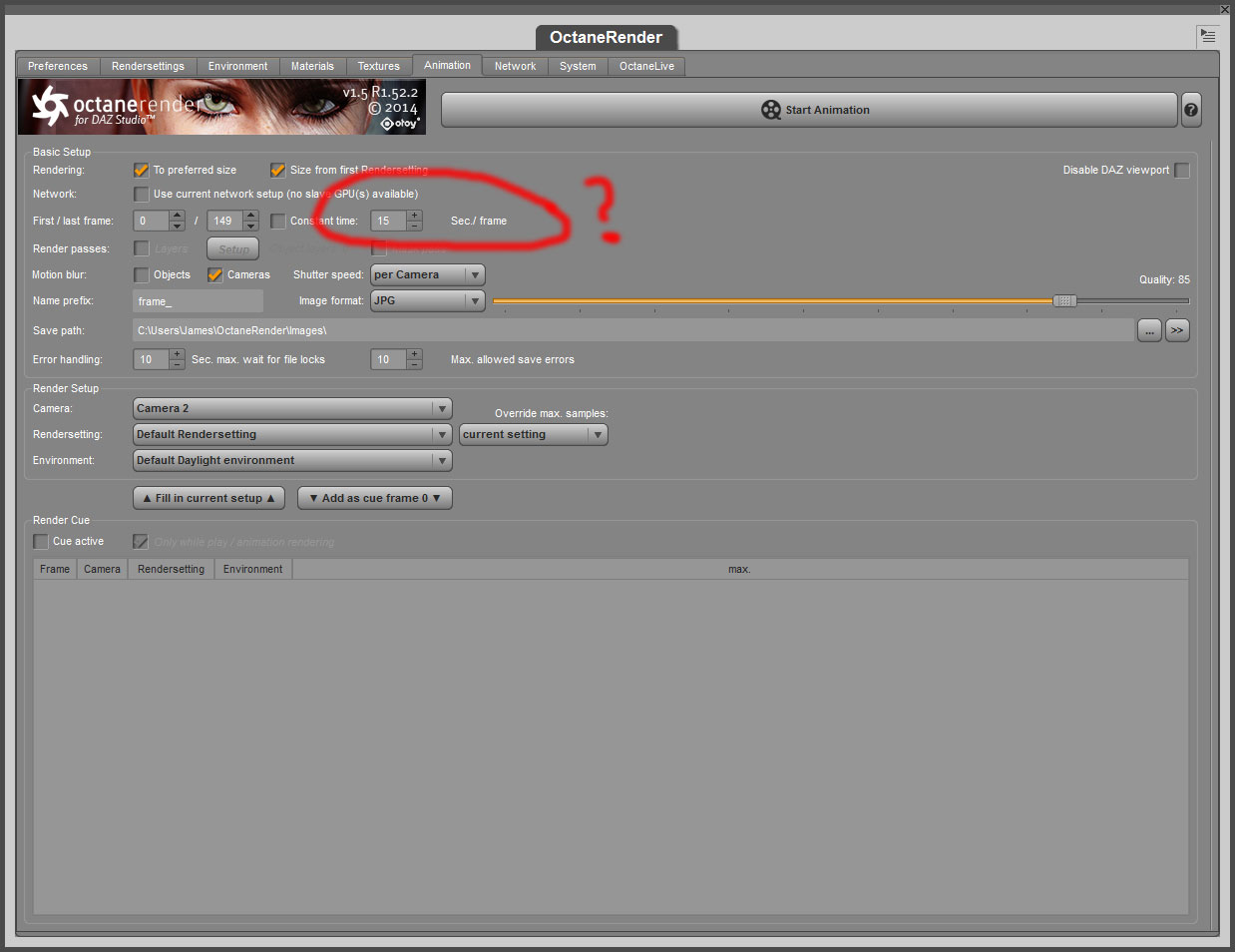

Hello,
Yes, its me again. I've been putting a lot of time into finding a work-around from the Daz Alembic Plugin (DAP) and OcDS plugin. I figured out a way to use both to give me the features I'm after, but I hit another wall that is going to need a fix.
When I open a .abc file created with OcDS it generates thousands of frames in Oc Stand-alone (OcSA). I have to drop frame slider to 1fps to match the actual frames exported. When I open an .abc file from DAP in the same scene the frame rate clashes and ultimately causes a crash in OcSA. If I open the .abc file from DAP first, the frame rate is roughly whatever it was in DAZ (24, or 30 fps). Of course opening the OcDS.abs file will cause a crash if you try to monkey around with the fps.
I think the problem is with OcDS. Check this screen shot.
Notice the description says "Seconds / Frame". And the minimum setting is 15. If I wanted it to match 30fps, it should go to as low as 0.0333...3
What does spf refer to? Did it get transposed?
Is this what causes the OcDS.abc file to show thousands of frames when there should only be a few hundred?
Is this mismatch of fps causing the two alembic files to conflict and eventually crash?
What does "constant time" do? Is there is a time input that is converted to fps that is missing or on another tab?
James

first off: the alembic export ist - like other thingss - not yet completely ready.kraken wrote:What does spf refer to? Did it get transposed?
James
the constant time option on the other hand has no effect on alembic export (and also not on fps) - it just tells the plugin, when rendering an animation, to render each frame for the given amount of seconds instead up to the maxsamples value of the render setting (maxsamples is in this case set to 256k)...
