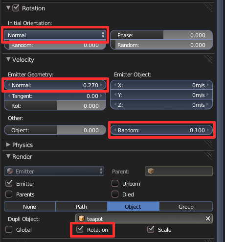

Which parameter are you referring to? Everything in the Velocity panel (which influences scale in case of hair PS) should work.kavorka wrote:I just noticed that the random scale value isnt being exprorted with the exporter, is that something that is possible?

I was trying to use the random size parameter under physics > newtonian > random size.
Does it read from the physics panel?
I don't see any random size parameter under velocity. How do you get random size?
Intel quad core i5 @ 4.0 ghz | 8 gigs of Ram | Geforce GTX 470 - 1.25 gigs of Ram
That works only for emitter PSkavorka wrote:I was trying to use the random size parameter under physics > newtonian > random size.
For hair PS, set initial orientation along normal, use the normal value to grow them and then the random parameter to randomize size. Be sure that rotation is ticked.
