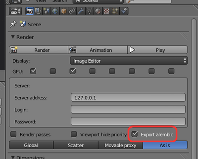

  • Added new feature: export of animation into OctaneRender Alembic file. The feature is implemented in the first draft, so you can test it...
    Only geometry and camera export is supported so far. Materials, imager, environment etc are not supported at this time, but you can tune them in standalone after export.

To export Alembic file instead of animation rendering - just set the "Export alembic" checkbox before starting animation rendering.

JimStar wrote:To export Alembic file instead of animation rendering - just set the "Export alembic" checkbox before starting animation rendering.
wow, impressive

I need to test this.
So, I can export my scene and camera animation (for a flythrough of a building) and then set it up in Octane standalone and render?
I was just trying to figure out how to do this the other day.
Intel quad core i5 @ 4.0 ghz | 8 gigs of Ram | Geforce GTX 470 - 1.25 gigs of Ram
JimStar
Posts: 3835
kavorka wrote:So, I can export my scene and camera animation (for a flythrough of a building) and then set it up in Octane standalone and render?
Yep.;)

Hi, I have many scenes and complex models for which I have created all the materials in Octane standalone.
Do you think that there would be a possibility for the plugin to convert the materials contained in ocs, or ocm or orbx files into a node setup inside blender, to allow the direct use of already made objects or scenes inside blender without the need of re-creating all materials ?

ROUBAL wrote:Hi, I have many scenes and complex models for which I have created all the materials in Octane standalone.
I was thinking the same thing and have found a work-around that seems to work well.
The big picture is to use your current octane standalone scene with materials and use a blender alembic file for just the camera and motion.
the details:
- go into the same blender file that has the mesh for your standalone scene
- animate a camera, hide the larger mesh items but leave a mesh cube so it has some geom
- check the export only shown items and check alembic, export the animation to alembic (should be a very small file)
- now in the standalone scene, add a group node connect both scene mesh and alembic mesh
- connect the alembic camera and that group node to the render target.
what you should be left with is a scene that uses the camera from the alembic file and your current standalone scene with all your materials intact.
